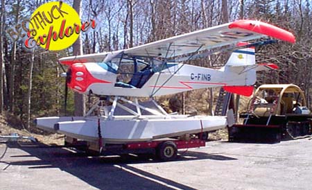

I notice there are two styles of wing tips being offered at the present time. The classic drooped tips and the Hoerner style.
I have the drooped style on my plane but I was wondering if any one has tried both styles and found any increase in lift of one style over the other. I fly entirely off water on floats ( the only way to go ) and as you expect every bit of lift I can get is appreciated.
C-FINB is ready for flight if the ice will ever melt!.... next week is looking good.
[img]cid:151192002(at)06052007-17F1[/img]
Picture taken last spring.
It was mentioned to me that the drooped tips obscure visibility... Has any one else noticed this?

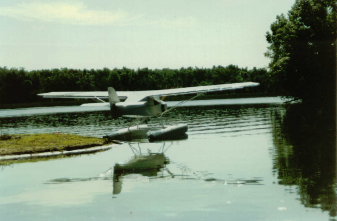

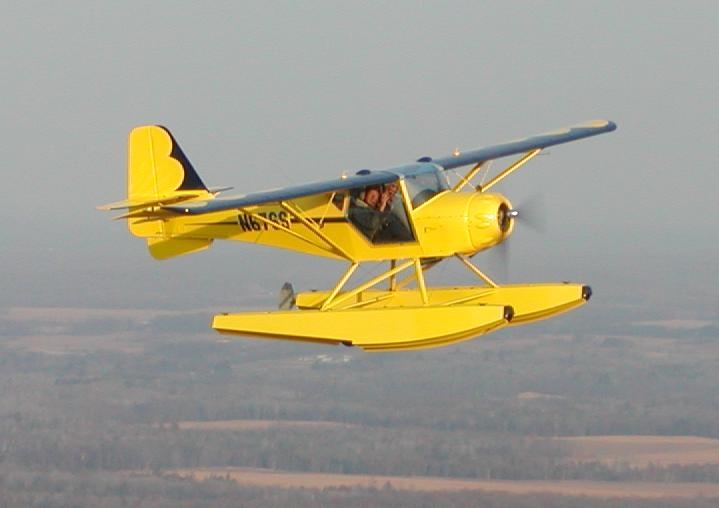

Leonard, I put 1300 hours on three different Avid Flyer models, 90% of those hours on floats. And none of those hours included use of a ventral fin. I never noticed any issues for not having one. The Avids flew beautifully on floats without a ventral fin, and they were extremely maneuverable in all flight modes (fwiw - I did most everything you can do with one on floats too...)
In the last 2 years I have been flying a Kitfox IV-1200 on amphib floats. It has the standard Kitfox ventral fin. It too flies good as a seaplane, but will not slip anywhere near as well as the Avid Flyers did. I suspect that is because of the ventral fin on the Fox, and the fact that the Avid has a "notch" in the back of the fuselage that the Kitfox doesn't. I've not bothered flying it without, but believe if I did it would just take a little adjusting to the increased adverse yaw.
So in my opinion adding a ventral fin to an Avid (or a kitfox for that matter) is probably a little overkill. You won't see significant flight characteristic changes. And the airplane will have adverse yaw either way.
And last but not least, one big detriment of having a ventral fin is when you try to turn the airplane around on a dock, you can't swing the tail over a dock without hitting the ventral fin. Kind of a pain.
