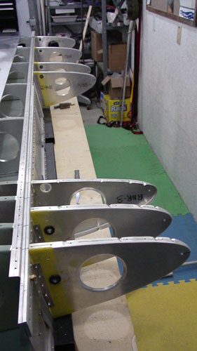

When you install the 15 gallon tanks you move the rib from the position of the L that you cut off to another flange outboard of the tank. You still have 7 Nose Ribs - 3 inbd of the tank and 4 outboard.
See pix.
Tim

So I will need to add a new nose rib "L" for the relocated nose rib #4? Thanks for the pic. What is the new position for the relocated nose rib #4? I could not find any reference to this in plans or assy docs, i.e., modifications of the spar/nose rib attachment points to support the long range tanks. (Maybe I did not look hard enough)
Dave

PatrickW
Joined: 27 Oct 2006 Posts: 380 Location: Fort Worth, Texas
Posted: Tue May 15, 2007 8:52 am Post subject: Re: 601XL outboard spar and long range tanks |
| Tim Juhl wrote: | | See pix.Tim |
Gotcha. Thanks. I'm ok.

Pls disregard the last post .. I found the location, just the other side of the hat stiffener, on the drawing at 1750 from the spar root for the relocated nose rib #4 to support the long range tank.
Thanks for the help again, guys.

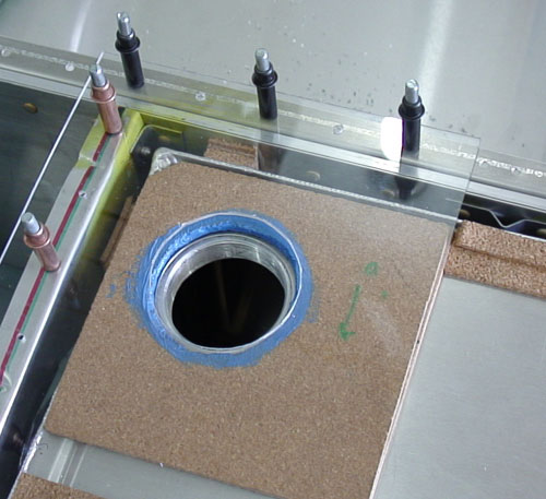

For what it is worth - I had to add additional cork to the ends of the fuel tank to get a snug fit using the ZAC rib locations. IMPORTANT - Fitting the tank is difficult with both the #3 & 4 ribs riveted in place. In my case I didn't rivet NR4 until the tank was installed because my capacitance type fuel sender was installed on that end. If you used the standard float type you might want to hold off on riveting NR 3 until everything is fitted and the tank installed. I also had to build up some cork around the filler hole (about 5/16") to make a snug fit without pushing the skin down around the neck. See pix.
If your filler neck turns in with any difficulty at all you might want to get on the list for the "big tap" loaned out by ZAC. On one of my tanks when I hand screwed the neck in and left it for a couple of days I couldn't get it back out. The threads crossed and locked and I had to destroy the neck to remove it. If you want more info do a search of Fuel Filler Neck Woes.
Tim
