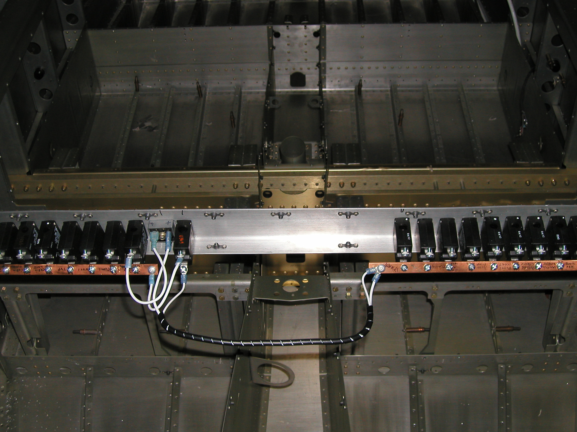

Here's my setup. Everything must be pullable or toggable. see the pictures.

brinker(at)cox-internet.c Guest
Posted: Fri Feb 10, 2006 12:52 pm Post subject: Toggle Switch Breakers |
David that is a nice clean wiring set up, you have given me some
idea's. What type (gauge,size) of aluminum angle are you using to mount
your switches in ?

dlm46007(at)cox.net Guest
Posted: Fri Feb 10, 2006 3:34 pm Post subject: Toggle Switch Breakers |
I drilled the standard crossmember and drilled corresponding holes in the
bus bar which is copper .125 x .5 x length. I believe I bought the copper
in 24" lengths. If additional rigidity is desired one could rivet an
aluminum angle along the bottom end of the crossmember. My panel is .090
thickness and powder coated.
One additional though on the angle. Don't put it in where it will interfere
with the throttle quadrant etc.
