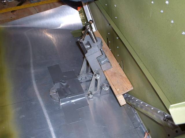

All-
Anyone at this stage in the game knows exactly what I'm doing.This literally came to me in a dream. 5 minute set-up, dead nuts accuracy. Save a tree!
This has probably been posted before. If the same idea's in the archives, stomp on this post.
Bill Naumuk
HDS Fuse/Corvair
Townville, Pa

Neat! Just don't forget that the floor is angled too. Three degrees according to the diagram in the upper right corner of 6B15.
-- Craig

All-
To answer all the well intentioned XL-ers out there, the bottom left diagram of 6-F-6 of the HDS plans call for "Angle between the floor skin and firewall, 80 degrees". You guys ought to know me by now- after all the times I've been burned, I wouldn't fart without a can of Renuzit on hand!
Bill Naumuk
HDS Fuse/Corvair
Townville, Pa

In a message dated 6/11/2007 9:53:46 P.M. Eastern Standard Time, naumuk(at)alltel.net writes:
| Quote: | | To answer all the well intentioned XL-ers out there, the bottom left diagram of 6-F-6 of the HDS plans call for "Angle between the floor skin and firewall, 80 degrees". |
Bill, this 80 degree is also on 6F-9 in two places but on 6F-8 the lower engine mount bolts are shown as 10 degree and upper ones at 13 degrees. Not sure how you can explain all the difference degrees.
Also 6E-3 has the engine mount at 103 degrees to the firewall and (?) crankshaft. Tolerance: Thrust Line within +/- 5 degrees to top longeron (up or down).
Jerry-GA
