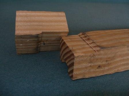

Scott,
I made my joggling blocks from 1 1/2" x 2" hard yellow pine boards that were a part of the ZAC shipping crates. See attached photos. The offset is ~5/32" or 4mm by ~1". I placed the aluminum angle on the long block, end of angle flush with the end of the block. Align the top block with the joggle and give it a couple of sharp whacks with a mallet. Sometimes, I would clamp the vertical leg of the angle with another wood block to eliminate distortion of that leg. Questions?

Very nifty. Do you have a picture of the finished, joggled parts? My
own experience joggling with such a setup is that the joggle is nice
and crisp near the "break" but, towards the end of the part, the metal
progressively "relaxes" and "unjoggles".
Ihab

Ihab,
I have attached photos of a 20mm x 20mm x .025 angle scrap that I just joggled.

Thank you! Somehow looks a lot better than my results. I'll try your
jig idea! -- I

joggle bars or joggle blocks work very well for formed sheet angles but to a lesser degree on extruded sections. We were able to use aluminum and steel joggle blocks on extruded sections back at Cessna Experimental though - make sure that the binding edges (that acturally form the departures from straight) are polished to avoid marking the extrusion - especially near the radius.
