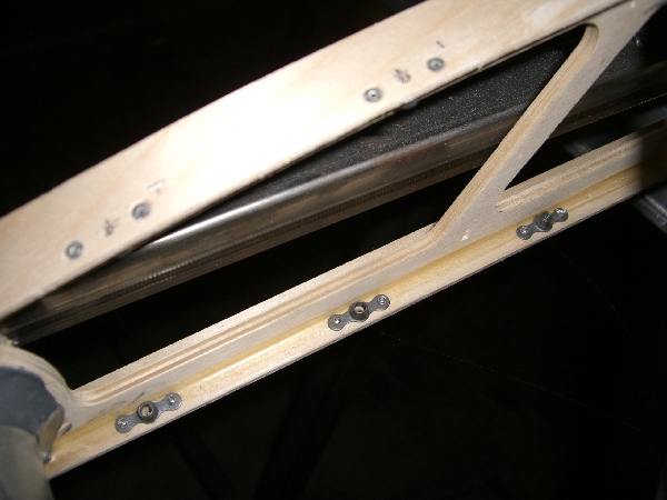

I came across this handiwork and liked it enough to save it. I believe it was a Just Highlander builder, sorry, no name.
