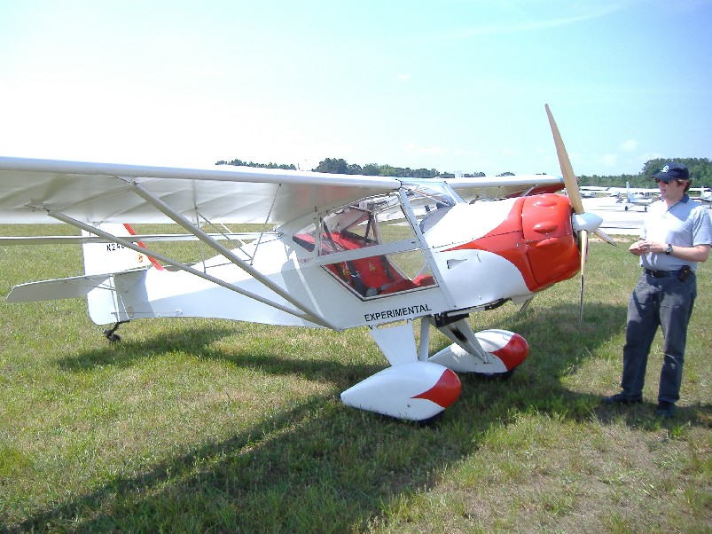

Posted: Wed Aug 22, 2007 6:14 pm Post subject: Re: 582 engine adjustments |
Good stuff. I will consider running it without the prop to adjust the air screw by ear without getting sliced and diced. This guy who has looked at it once claims to be experienced with two cycles. He is an aircfraft owner and pilot but his experience has been on motorcycles and such. We ran the engine after moving the needle valve from the third notch to the second. After running the engine like that and looking at the spark plugs, he felt it was running too hot, and we put it back to the third notch. I flew it today after setting the pitch for 6200RPM static. I saw about 1050 on the EGT, which I hear is about right. I would say it ran cooler with the lower pitch, but the OAT was much cooler, and I still saw 180 deg F a time or two. The cloud above me sprinkled a bit on my windshield. Naturally I thought I had sprung a leak and high-tailed it home. It is still four cycling at the lower RPMs. We had messed with the air screw before, but after reading those aforementioned web pages, I reset them to one turn out. I think it is worse now. Are they still affecting the mixture in the 4000-5000 RPM range? I have to get above 5000 to guarantee no skipping. Thanks for your insights. I attached a picture for grins.

Posted: Wed Aug 22, 2007 7:23 pm Post subject: Re: 582 engine adjustments |
great looking bird! The midrange is what seems to be off. What jets are you running? and when you look at the jet chart, are you looking at the one with our without the air intake silencer. I have seen this happen...and the wrong jets were installed. Of course, since this is a midrange problem, you could go for the in-flight mixture adjustment and your problem should dissapear, as well as being able to richen up a tad on decent to keep the EGT's under control.
Did you verify the idle RPM with the optical tach?
4-5 thousand is the midrange needle to the main jet area
