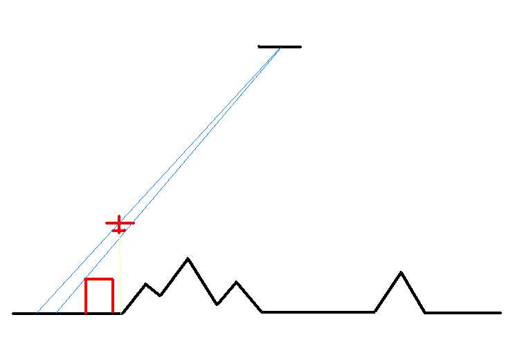

Posted: Wed Aug 29, 2007 2:45 am Post subject: Weird 747 shadow |
Hi Andrew,
It gets a little complicated......
The 3D effect is used by many companies to create the terrain model used by so many applications. It could be flight simulators, or GPS units with ground proximity in them.... What Google is doing is using that model to 'drape' their imagery over it to give you that 3D effect.
I'll take a look at those examples when I am back at a fast modem, but I have another 'possible' explanation for what you are seeing.
In order for an orthophoto to be scaled properly the original photo has to stretched and shrunk to fit the terrain. Think of the left side of a photo as having a mountain, and the right side with a valley. The two sides of one photo will have different scales...... This effect is further complicated by the fact that only in the center of the image is the camera looking directly down, vertically. For most of the image, the subject is at more and more of an angle off center.
This 'looking off center' is not an insolvable problem as long as the object is draped onto the terrain model. But any object that stands proud from the terrain model is going to be put in the wrong place. The higher something is, and the further off perpendicular from under the camera, the more horizontal error will be introduced when the object is forced down to the terrain model.
So tall buildings will appear misplaced. Aircraft could appear a great distance from where they should have been on the earth directly beneath them.....
The simple answer is; every image pixel needs a proper elevation in order to be placed accurately in horizontal.
As for multiple images causing ortho-weirdness, it does all the time. Things like a baseball field with way too many players and a bunch of other errors, some of them quite funny......
David Owens, on this list, I'm sure takes quite a lot of imagery destined for ortho photos also, with their Colemill 500A.....
Steve

Posted: Wed Aug 29, 2007 5:14 am Post subject: Weird 747 shadow |
For what its worth, I think it has to do with shutter speed. Slower shutter speed which allows better detail. In addition, a lot of these are not sat photos but are aerial photos that are piece milled in.
Bert

Posted: Wed Aug 29, 2007 6:32 am Post subject: Weird 747 shadow |
Actually, when you use some of the GEO software such as Leica Suite, and Imagine, some of the features you can choose to "merge" the images seamlessly allow you to "feather" the images, which makes the image progressively trsnsparent to the extent of the image... to appear more seamless between frames, as well as auto dodging, which will change the actual gamut of each image to match more or less creating another aspect of "seamless" as the eye can see... color and density assuming the images were captured at or near the same sun angle, weather etc. As for the "ghost" shadow, I think it was feathered below the image that was overlayed after, like you guys said... BAWK!
