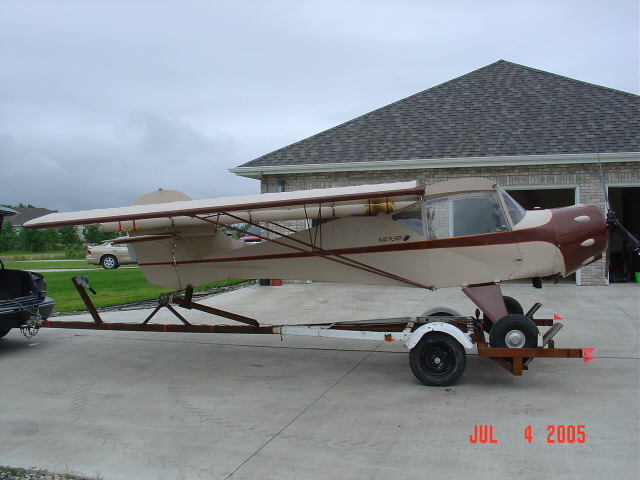

Float Flyr
Joined: 19 Jul 2006 Posts: 2704 Location: Campbellton, Newfoundland
Posted: Thu Nov 01, 2007 4:07 pm Post subject: need King Fox rims |
The idea of removing springs sounds Ok to me as long as you leave about 1500lb capacity. You will want some margin of safety between the weight of your plane and the capacity of the trailer.
I found it is much easier to open the wings without installing the turtle deck to load and unload the plane. This made handling the tail much easier. I also have a stand that fits exactly under the nut and bolt for the tail wheel spring. The stand is to keep the plane level when towing. The reason to put the stand under the tail wheel spring mount is to take pressure off the spring itself.
In the following picture I only have the plane on the trailer to take the picture and at that time I hadn't worked out how to guy the tail wheel three ways so it cannot move while travelling.
Notice how the trailer ramps reverse to block the main gear in place. It cannot move left, right forward or back. I expect if I could roll the trailer upside down the plane would not separate from the trailer. Note the straps do not attach to the main gear but only to the loading ramps. In the position the plane is in it would be next to mission impossible to lift the tail up onto the support. with the wings open and the main gear trapped it is actually quite easy to place the support under the tail heed spring attach nut.
The three way guying I mentioned is 1 the main cable from the winch to the tail wheel. this cable will have to be loosened to lift the tail then tightened. 2 and three guys are ratchet straps which attach to the same part of the spring and extend to the rear corners of the platform. I was considering bolting a couple of boxes on the platform to put gasoline in. I don't recommend towing with gas in the wings. Be sure to put some kind of a protection between the vertical stab and the ailerons to protect the stab from abrasion. Also be sure to tie the ailerons together behind the rudder. Don't trust the small supports at the base of the vertical stab to hold the wings in! If they open while towing it will put a dent in your day.
[img]cid:268574723(at)01112007-2DDF[/img]
This is the way I usually tow my plane short distances... only with the wings folded, of course.
[img]cid:268574723(at)01112007-2DE6[/img]
Noel Loveys, RPP, AME intern
Campbellton, Newfoundland,
Canada
Kitfox Mod III-A, 582, B box, Ivo IFA
Aerocet 1100s
noelloveys(at)yahoo.ca (noelloveys(at)yahoo.ca)
[quote] --

Posted: Thu Nov 01, 2007 6:43 pm Post subject: need King Fox rims |
I have a remodeled boat trailer for my Avid Flyers. I didn't build it, it came with the Avid B. Jim Chuk, Avid B 582, Avid Mk IV Jabiru, Chisholm Mn

Hi Noel.thanks for the info on trailer.I have a boat trailer that I plan
on hauling my plane on backwards.it is a 3500 load I am going to extend
it by app 3ft. ,, drop where the KF2 will sit. and now I have to widen
the outer frame rails to app 75' so the KF will have room.all so it too
will have a hand winch.and incline channel to bring tail up level on
front of trailer.so less stress on wings and tail.when going down the
road.all so will take some leafs out of axle to make soffer ride for
KF.trailer will all so have a tool box.off of a Pick up .what do U think
Noel?? will this work?? Thanks again Steve Shinabery N554KF KF2

I didn't realize the pics would be so small, but I think there is a way to expand them. I meant to mention about how the tailwheel is held in place. There are two hinges welded on on each side of the channel/ramp with staps welded to them. When you flip them up, you can run a bolt through the straps and one of the cross tubes in the fusaloge. This supports the tail so it is not bounceing on the tailwheel spring and ofcourse holds the tail to the trailer. I'm not sure if the Kitfoxes have them, but Avid had two crosstubes in the tailend of the fusaloge that you could hook a hitch to and tow the plane on its own wheels. Jim Chuk Avids, B, MK IV, Minn

Hi Jim Thanks 4 the info.and yes my Kitfox all so has the cross over
tubes.and I will use your idea on my trailer allso.I thought about this
too but did not know how to do it..And now I do.this will help me out
greatly..Thanks Steve Shinabery N554KF KF2
Jim_and_Lucy Chuk wrote:
[quote] I didn't realize the pics would be so small, but I think there is a
