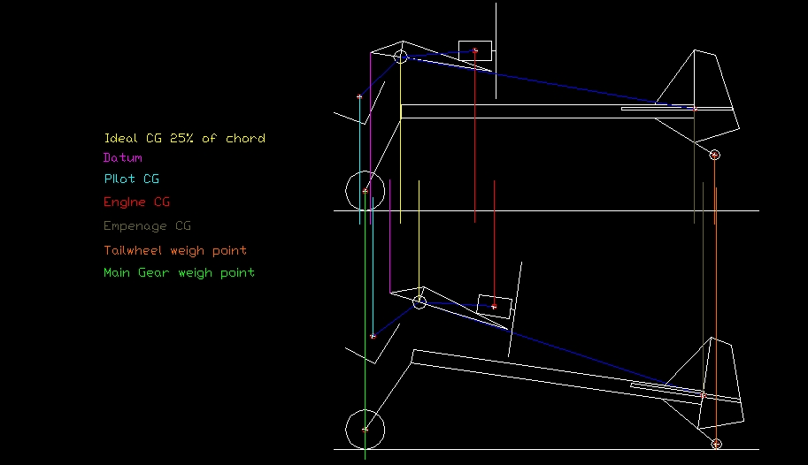

Hi guys. I am trying to do my weight and balance today for my Mark II. I don't have any information on what the level flight is. We leveled up the horizontal stabilizer. I've attached a picture.
Any information (very soon) would be appreciated.
Cristal

it should be 9 degrees angle of wing cord on a kolb
Here's an old drawing.

Ray, it's pretty a simple trig problem to see that measuring the W & B in the landed configuration will be inches off. Really bad advice on your part. Do it on your own plane if you like, but don't advise someone else to do it.

However, what is it you are telling me about the "CG being aft" in the ground position, (similar to a climb attitude)?
If what you say is true then it means that initiating a climb attitude makes your CG go aft and would be rather alarming if true.... right?
That implies that upon initiating a steep climb the CG goes way aft and SHOULD result in uncontrolable spin as the CG goes beyond the aft limit.
We all know that CG does NOT change from a simple pitch change...right?!
How many of us are spinning in on takeoff?
So there is something else going on here....and I am going to illustrate with an example as soon as I can so people can understand what I am telling them.
Perhaps they are not using one of the correct methods for determining CG, but I'll straighten that out with my example.

The CG does shift aft when in a climb and with the tail on the ground, just
denying that fact doesn't change anything. Anyone that has ever lifted the
tail of their airplane knows that the tail is lighter when lifted to the
specified W&B position. Lift it high enough and the tail will keep on going.
Now maybe where ever your head is at it doesn't do that but it does here in
the Midwest. The CG ranges are calculated based on a specific attitude. If
they were calculated with the tail wheel on the ground they would be
different. The CG ranges are given with the idea that the plane will be
flown in allot of flight attitudes and not get us in trouble. You can do
your weight and balance your way but please don't try to advise others this
way. Also please if you do your W&B your way don't take anyone up in your
plane or fly over populated areas.

Weeeeel, this is MY opinion and everyone is welcome to ignore it. CG does NOT change unless weights are shifted on or within the airplane. IMHO it is a constant, when in the air! -- unless you move baggage, lean way forward, shift weight around. In any case the aircraft's ATTITUDE will not move the CG, has nothing to do with it.
This is a serious and potentially dangerous area. if you're confused, forget the amateur experts and consult a knowledgable person. May take some work to find one but your life is worth it. Ignore any advice that sounds questionable.
IMHO; feel free to ignore if you wish.

For what its worth, i weighed my MKll tailwheel on the ground and elevated 2'. It weighed 5lbs less elevated and the mains weighed 2.5 lbs more. I used the elevated weight for my weight and balance....Mike

"CG does NOT change unless weights are shifted on or within the airplane. IMHO it is a constant, when� in� the air!"
Absolutely correct Rick! Not just your opinion, but solid irrefutable physics. Unless mass is moved, added, or subtracted, the CG of the plane does not change. This is true on the ground and in the air.
The distribution of weight on the scales and therefore the calculation of C.G. with respect to a datum does change with attitude on the ground. One can choose any attitude one wants with a new design to measure this position and verify limits with flight testing. The important thing is that (once the testing is done and limits set) all those thereafter make their measurements in the exact same manner.
Builders use different tire & wheel sizes, custom landing gear, short tail springs etc to costomize their craft. Because of this. using the wing bottom at a set angle to level makes for a much more repeatable process than taxi attitude. This lets us all benefit from the flight testing done by the initial designers. Doing it any other way puts the EXPERIMENT back into EXPERIMENTAL.

Of course those who have replied that the CG does not change with attitude are right ! Those who have (correctly) observed that the tail weight changes as you lift the tail are getting confused -it does not mean that the CG is moving!
The weight and balance check should be done with the lower wing surface set at 9 degrees to the horizontal. On my machine, the tailwheel is 9 inches off the ground to achieve this.
What would be MUCH MORE INTERESTING is what other MkII owners use for the position of the Pilot/passenger CG,, as it makes a big difference in the calculation. Previous owners of my plane have used a figure of 4 inches forward if datum (the front wing edge), but I reckon it is more like 2 inches. Are there any other opinions?

One option is to use the exact position of the pilot CG for the calcs.
The easiest way is to do a weight with the pilot sitting in the plane.
Assuming you have already done the EMPTY weighing and calculated the CG
you can work the whole "weight x arm = moment" thing in reverse, since
you have the empty CG and then you get the CG with the pilot in the
plane (from weighing) that can be extrapolated out since you know the
change in CG position and the weight of the pilot...just solve for the
ARM.

Ray, It is said a picture is worth a thousand words. Perhaps this will help you understand why your idea that it makes no difference the position in which the airplane is weighed is mistaken.
Rather than doing trig problems as I suggested earlier, just look at what happens to the relative position of the datum between setting on the ground and level flight position.
Notice the tailwheel position changes very little.
Look at how the cg of the major components, wing, empenage, pilot, and engine, move.
Now, compare the arm from the datum to the tailwheel contact SHORTENS when you measure it. while setting on the ground. This mismeasurement of the arm is why you will get a total CG that appears to be forward of where it is actually when the airplane is in flight.
Hope this helps.
Rick

[quote]--> Kolb-List message posted by: "Richard & Martha Neilsen" < NeilsenRM(at)comcast.net (NeilsenRM(at)comcast.net)>
Ray
The CG does shift aft when in a climb and with the tail on the ground, just denying that fact doesn't change anything. Anyone that has ever lifted the tail of their airplane knows that the tail is lighter when lifted to the specified W&B position. Lift it high enough and the tail will keep on going. Now maybe where ever your head is at it doesn't do that but it does here in the Midwest. The CG ranges are calculated based on a specific attitude. If they were calculated with the tail wheel on the ground they would be different. The CG ranges are given with the idea that the plane will be flown in allot of flight attitudes and not get us in trouble. You can do your weight and balance your way but please don't try to advise others this way. Also please if you do your W&B your way don't take anyone up in your plane or fly over populated areas.
It is obvious you think you know more than than everyone else and that is fine. Just keep it to yourself and keep flying. Some day when the grim reaper comes calling your bad advise will stop once and for all.
As usual this is just my opinion and worth what was paid for it.
Rick Neilsen
