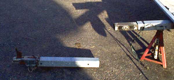

A close up of where I cut the tow arm... So I'm not too good with a cutting wheel. This picture also shows the 1/2" bolts I use as tow pins. They are held in place with cotter pins only as the load is completely shear.
[img]cid:174533519(at)06112007-07BE[/img]
The tow arm is off.
