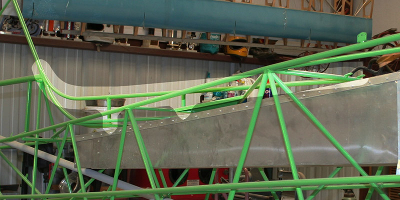

MichaelGibbs(at)cox.net Guest
Posted: Sun Nov 11, 2007 8:40 pm Post subject: uncoordinated turns |
Jack sez:
| Quote: | ...I was wondering if when it comes time to recover my plane if
maybe giving it a vertical similar to the Maule M-5 wouldn't help
keep it's heading easier? Has anyone ever tried this? It seems
like it could be done.
I assume you are talking about the extended leading edge of the
vertical stabilizer that curves into the top of the fuselage, right?
The dorsal fin, as it were?
I did that on my Kitfox. We welded a piece of steel tube from the
rear of the turtledeck to a point about 8 or 9 inches up the front of
the vertical tail, with a smooth curve just forward of the tail. We
also welded in a couple of vertical stand-offs to support the span.
I've highlighted this portion in the attached photo.
It made covering that area easier and I sure like the look. I don't
know how much improvement in yaw stability it provides because I
don't have anything to compare it to.
Mike G.
N728KF
Phoenix, AZ

dave
Joined: 22 Sep 2006 Posts: 1382
Posted: Mon Nov 12, 2007 2:40 am Post subject: Re: uncoordinated turns |
| Quote: | | I have a model II and I've been working to regain my skills out at a local dry lake. I too have noticed the different yaw and coordination traits of the Kitfox. |
Jack, it sound like your are just noticing more effort that you might be used to of co-ordinating your feet and hands. Your Kitfox 2 has no aileron differential built in so you will be more prone to more adverse yaw.
It is likely very manageable as you learn to fly it. I think John Mc Bean might sell a kit to make aileron differential on your Model 2. Model IV up had it already built in and makes a better flying Kitfox in my opinion.
That being said the Kitfox 2 is a far superior flying plane to many other brands that are very popular. adding more vert stab might help but I doubt it will do a whole lot for you alone.
