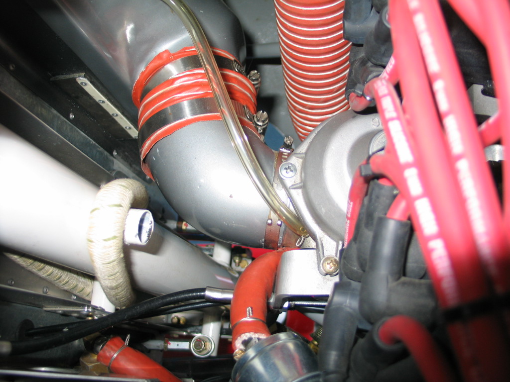

I had an interesting week working on the Bing carb on my serial #2062
Jabiru 2200A engine. I had been running the engine with the cowl off,
and I noticed that fuel was going up the clear tube that is the carb
bowl vent. I assumed that this was a temporary overflow of fuel and
it would soon be gone with the engine running, but it was not.
However, revving the engine got rid of the fuel in that line.
Finally, I closed the main fuel valve, and shut the engine off. I
then took the incoming air hose off the carb, and about a half-cup of
fuel gushed out. This led me to believe that the float needle was
leaking...DUH! It turned out to be exactly that. I ordered a new
needle and seat, and a #40 idle jet. The reason for ordering the jet
was I had read others' comments that the #40 jet took care of their
idling problems. With the new needle and seat in place, and #40 jet
too, the engine ran great, and I could get the idle down to below
900, and it was smooth. Later on, I decide to test the old #45 jet,
so I reinstalled it, and the engine ran great with that (original)
jet. So my major problem was with the float needle and seat, and
nothing else. Amazingly, I have had this bad idle problem for some
time now, and it's been a leaking needle and seat all along. I had
been just learning to deal with the rough idle.
Along with curing the rough idle, I no longer have to shut the main
fuel valve off 30 seconds before I shut the engine down. I thought by
doing this, I was lowering the fuel level in the float bowl, and
thereby keeping the carb from "boiling over", but I was just using up
the excess fuel that was already (probably) laying in the inlet air
hose.

agbeyer(at)sbcglobal.net Guest
Posted: Sun Nov 11, 2007 8:05 am Post subject: Carb jet changes |
Here are some pics of the intake elbow I made.
Zodiac 601HDS, 3300 Jabiru (350 Hrs.)
Al from Oshkosh
| | - The Matronics JabiruEngine-List Email Forum - | | | Use the List Feature Navigator to browse the many List utilities available such as the Email Subscriptions page, Archive Search & Download, 7-Day Browse, Chat, FAQ, Photoshare, and much more:
http://www.matronics.com/Navigator?JabiruEngine-List |

Lynn Matteson
Joined: 10 Jan 2006 Posts: 2778 Location: Grass Lake, Michigan
Posted: Sun Nov 11, 2007 2:33 pm Post subject: Carb jet changes |
I see that you have the air inlet tube coming in from the side. This
is what I was warned against, both in the workshop at Sun 'n' Fun and
in reading the instruction "manual." They say the airflow should come
in from below or above, not from the side, as coming from the side
sends different signals to the two air sensor ports in the top of the
carb throat. But with 350 hours on yours, it must be working well.
I've got ~435 on mine and it works well. I guess that's why we
experiment.
