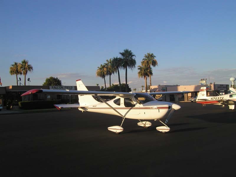

I originally had to go into hibernation on the build because my work sucked up all my time and energy. However, just recently another impediment came along. I hate to rent. All that good money going out the window, so, guess what? After whining about not having a plane to fly until some at the airpark ran the other way when I turned the corner, I finally bought myself a plane. I'm now am having so much fun flying that that and the job give me no time to build. I do love building though, so do plan on getting back to it. Maybe sometime this winter. Unless, of course, I decide to redo the panel on my new toy.
For those who might not know the type. This is a Glastar, 2-place. Built by a wonderful craftsman, Charlie Eubanks.
John Jessen
