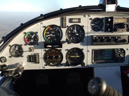

Hi, i fly a 601xl with a 3 blade woodcomp and i have a very steep setting max take of rpm 4600-4700rpm
climbes with approx 900-1000ft/min but has a very nice cruising at 110-115 knts IAS with 4500-4600 rpm and approx 24hg MP
fuel com. approx 15ltr/hour
side effect with less rpm it is also quieter
