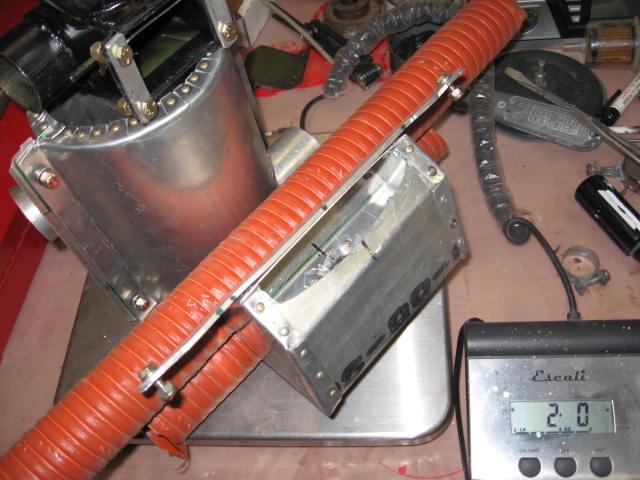

OK Gents...Just finished up a heater muff for my 912 speedster. I thought if anyone was going to undertake such a project, I might post these pics .
Total weight as shown on the scales was 2 lbs. And the Heater valve I fabricated of steel was 12 oz my itself...the single heaviest component.
All hardware is included on the scales except the scat hose clamps..which I didnt have the right sizes on hand, and the cable to operate the valve. Worked out pretty good...I just hope it heats!

Thx Gents...Well, before starting on this project I did a search of the archives from this list and alot of the dope I read influenced the design.
I have not installed them, but I have a sack of pot scrubbers on the bench!
The Valve on the firewall is a simply flapper type air diverter valve that opens and shut via a cable on the panel. it diverts the hopefully warm air either into the cabin or out thru the round outlet pointed down to exit thru the bottom of the cowl. I fabricated this myself from mild steel sheet and brazed it together. It is kind of a copy of other aircraft diverter valves I have seen in the past.
Lynn, In regards to the exhaust wrap. I have Tonys Book, and I am aware of his statement on pipe wraps. However, I also know if this products usage in many certificated applications and how effective it can be to reduce under cowl temps. My decision to use it on my craft was based on the close proximity of the coolant hoses to the exhaust pipes. The craft operated for about 100 hours without the wrap on the pipes, and the damage to the heater hoses was begining to show up. Also damage to the firewall blanket where the rear exhaust pipes come very close. I considered the really good airflow under the cowl that a round cowled KitFox has, and determined that was was needed was something to more or less "sheild" the hoses and blanket from the pipe, not necessarly to reduce the under cowl temps. Hence, I opted for the wrap. Since installing it..about 80 hours ago..I have kept a close eye on those hoses, and am very happy with the result. Only time will tell if there is any detrimental effects on the pipes due to holding in too much heat, and if it happens, I figure that a cracked pipe is a better failure than a busted coolent hose.
I will keep you posted on the long term effects.

Roger that Mike... the valve has 2 outlets..when it is closed to the cabin, it is diverted thru the outlet pointed down. I didn't stick a short hose on it yet. Don't think it will be needed but I made it so I could just in case. It would need to be about 6 inchs long and go straight down to the under-cowl opening. I believe this will also help keep some heat away from the lower motor mount rubbers, which as you know are real close to the muffler can. I am sure your 912 speedster is just like it. my motor mount rubbers show a little heat brittle on the edges closest to the can now. This heat muff oughtta help that some.
And Lynn, yes, I understand and agree, in fact, in addition to the wrap on the rear pipes that come so close to the firewall blanket, I installed small alum sheilds against the firewall over the blanket because with the wrap on, it just about touchs the blanket right on the bend. The heat had already cooked 2 black spots on the blanket in that 1st 70 hours.
And when I read Tonys book, I also considered that the EGT temps could get a bunch higher on the Mustang which probably had a 320 or a 360 in it, than on a 912, particularly when you have mixture control in the cockpit. Plus, he specified they were mild steel headers, not stainless like mine. These considerations gave me a little more confidence it the application.
As for the wraps on certified birds, they are pretty popular in alot of areas, especially the further south you get. I also believe they are required on a Aztec, and come standard on some models of Bonanza's.
When I was in College, at Spartan in Tulsa, we had wraps on most all of the 150's on the flight line. Of Course back in the heyday of Aviation..the early 70s, Those birds didnt cool off all day long, every day, as their flight training program was very very busy.
