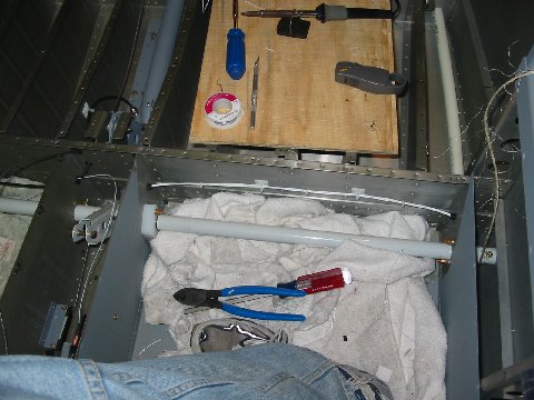

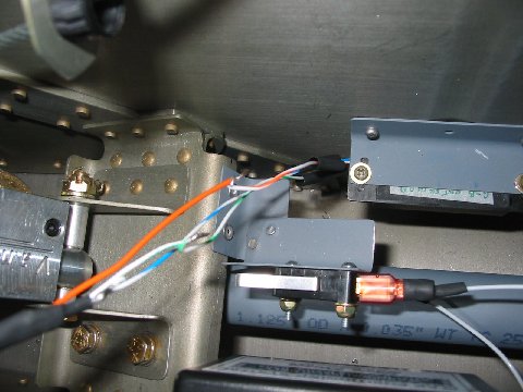

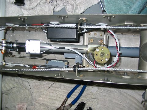

Whoops, my mistake, I thought you could see the POS-12 in those posted pictures. Here are some photos of my POS-12 installation. I attached it to the inside of the tunnel near the flap actuator using blind rivets. I made a connection using model airplane a threaded pushrod with a z-bend at one end an a brass clevis at the other. I had to measure carefully/experiment a bit to select the appropriate attachment points and mounting angle to get the right throw and to avoid binding.

Here's a couple photos of our Ray Allen Pos 12 flap position sensor.
We attached a tab/arm to the flap actuator bar/rod in the tunnel with aclamp.
The sensor is mounted on the tunnel side wall with a small bracket.
A small rod with an threaded joint connects the arm/tab to the sensor.
Eric
