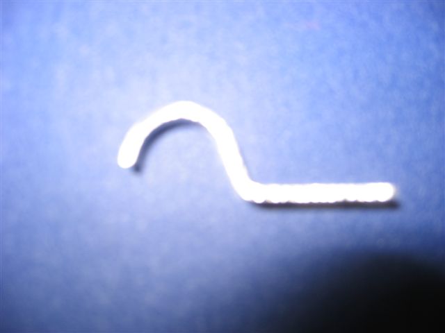

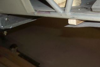

Jimz
Joined: 09 Dec 2007 Posts: 31
Posted: Sun Jan 20, 2008 1:48 pm Post subject: Aluminum Belly Pan |
A friend is building a series 5 and so am I. His kit came with an aluminum extrusion to use to cut out clips to attach the aluminum pan under the rudder pedals. He had me cut them for him and here is a picture of the extra one. This is the second plane that I have seen use them. They get epoxied to the tubes, then either a rivet or screw holds the aluminum pan.
Jim Z
Series 5 0-200
Covering.

Jim, Thanks for the picture. I will fabricate some of those clips. What brand epoxy do you recommend? Pat Reilly Mod 3 Rebuild Rockford, iL
[quote] From: jezim(at)pro-ns.net
Subject: Re: Kitfox-List: Re: Aluminum Belly Pan
Date: Sun, 20 Jan 2008 14:34:14 -0600
Jim Z
Series 5 0-200
Covering.

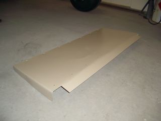

patreilly43(at)hotmail.co Guest
Posted: Sun Jan 20, 2008 3:58 pm Post subject: Aluminum Belly Pan |
Darin, Yes I don't think putting an aluminum belly pan on would be difficult. Looks easier than fabric covering. Thanks for the reference to Hysol epoxy. I didn't know what brand to use. I think a 2 piece belly pan would be easiest. Front one from firewall 1/2 way back, then another slipped under the front one to cover the last 2 feet. Removed, it would facilitate easier bungee access also. .020 Alcad aluminum would weigh 3 1/2 pounds and cost $50. It seems like a no brainer to me.
Pat Reilly Mod 3 Rebuild Rockford, IL

Just happens that I had the same thought as you that the Grove gear
area would create an area of extra drag between the gear and the
belly. I just finished fabricating a small belly pan which will be
attached at the front under the firewall flap using screws into a 1/2
x 3/4 wood cross brace which is in turn held to the fuse by screws
through the floorboards. (i.e. no holes in tubing.)
At the rear I have drilled and tapped a couple of holes into the
round aluminum gear retainers and then attached an aluminum angle
across the width of the fuselage. The bottom of the angle is flush
with the bottom of the Grove gear.
A couple of small photos attached.
Jim Corner
Model 2, 582,. Ivo med !FA, 1100 hrs
Model 5 under construction
Calgary, AB

Jim-
Does your pan extend beyond the Grove gear to the rear? If not, it
would seem like you'd get some turbulence behind the gear if the pan
just quit at the gear. I thought I'd slope my pan from the firewall
flap area down to below the gear, then slope it back up to where it
would again contact the fuse's fabric, and be held in place there by
the aforementioned machine screws and Hysol'ed clips inside the fuse.
