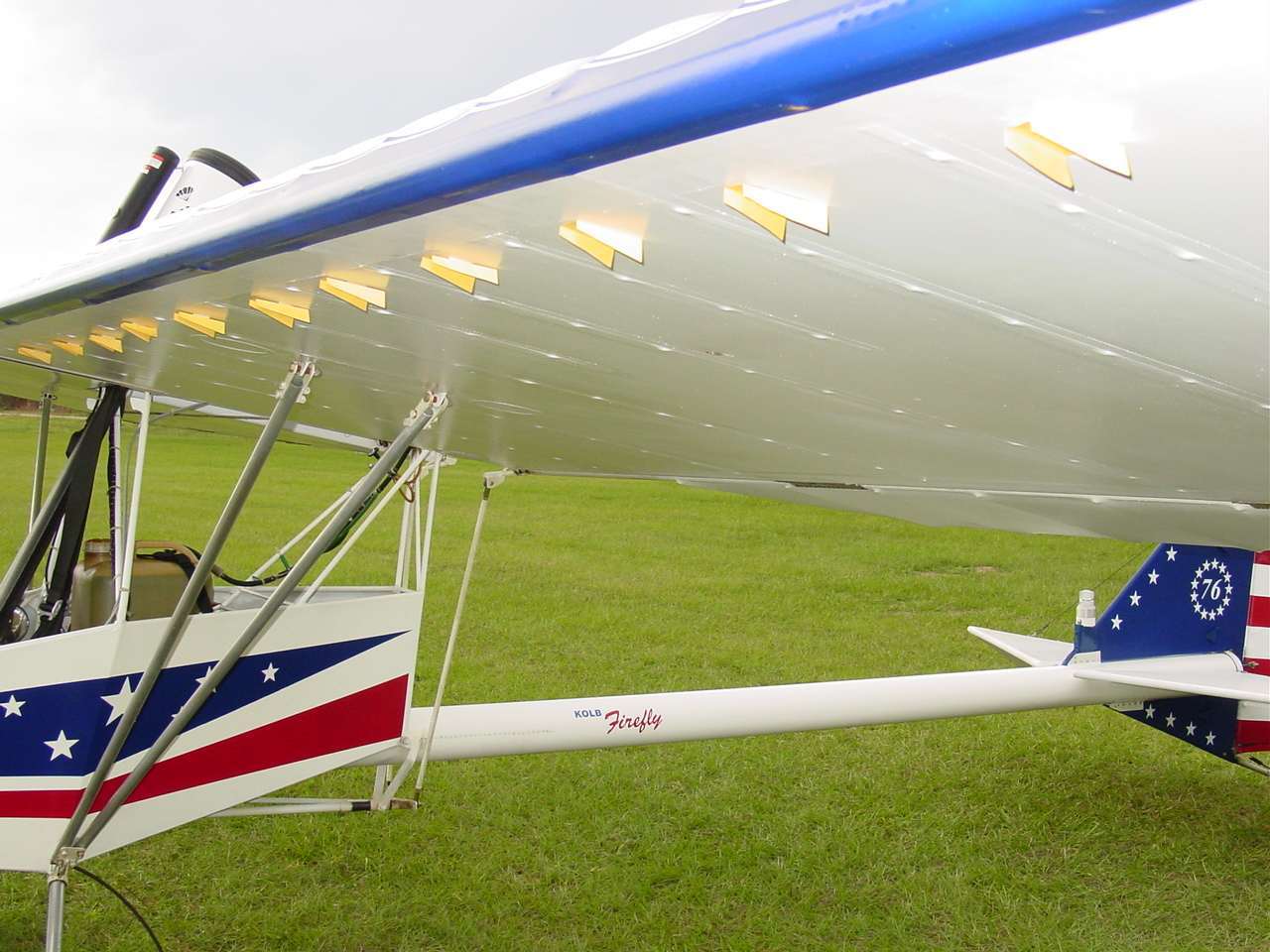

Although I have personally been somewhat disappointed with the performance of the VG's on the wings of the Firefly, I have nonetheless concluded that it is possible to enhance low speed performance in the cockpit area if one takes the time to carefully test to find the optimum location for the devices... It appears that abrupt, unexpected Kolb Drop inside the cockpit itself seems to be an often overlooked, yet recurring, problem in certain instances... Therefore, we Kolbers at Airport Manatee have initiated an aggressive engineering and test program to seek innovative solutions to Cockpit Kolb Drop in the hope that we might prevent an unnecessary tragedy.
As in the case of the "one wing" VG testing, this could be somewhat dangerous, so it is recommended that this cockpit testing be left to the more experienced Kolbers... perhaps some of those mired deeply in "VG denial" would stand to benefit most from the research... Volunteers?
