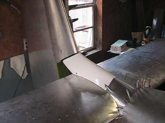

Definitely Bill. Wait until you hav ethe rear top skin at least clecoed in place so you can work out how the saddle sits on the H-stab and how the saddle's forward edge mates up with the aft edge of the rear top skin. I jumped in a separate piece of .016 to allow me to cut the aft edge of the rear top skin far enough forward so that the H-stab can be placed and removed in a vertical path compatible with the brackets.
