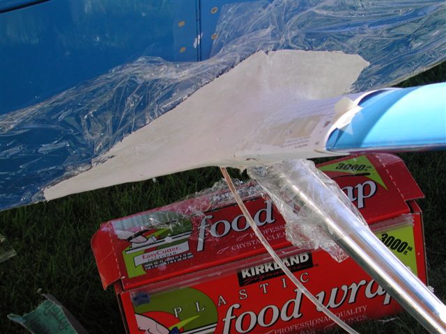

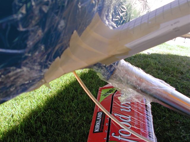

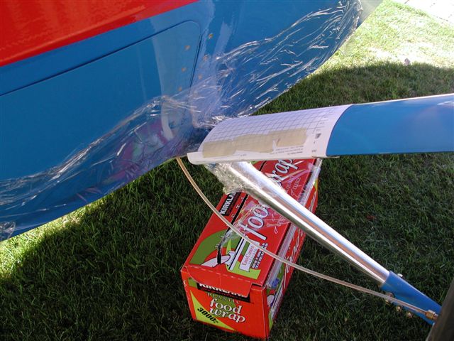

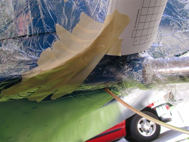

<<DSCN1892.JPG>> St <<DSCN1881.JPG>> ar <<DSCN1882.JPG>> te
<<DSCN1883.JPG>> d <<DSCN1884.JPG>> a <<DSCN1885.JPG>> st
<<DSCN1886.JPG>> ru <<DSCN1888.JPG>> t <<DSCN1889.JPG>> fa
<<DSCN1890.JPG>> ring for the bottom of the strut today step 1 I applied
food wrap to the fusladge
Step 2 I covered thr spar with paper
Step 3 with masking tape I made the desired shape
Step 4 with gauz and plaster I covered the masking tape
Step 5 removed the plaster part from the plane
Step 6 cleaned it up now it"s ready for the resin and glass
Uncle craig

Generally, to make a fiberglass part you have to make a mold. Usually, this mold is destroyed in order to get out your finished fiberglass part. That's why they refer to it as "lost mold".
In most situations to make a custom fiberglass part the sequence goes something like this; (let's continue the fairing for the wing struts)
1) protect the background structure from any mess you do. Uncle Craig suggested using plastic food wrap. His suggestion was very appropriate, because the mold material he was using was fabric and plaster of paris. That stuff isn't corrosive or harmful, just mainly messy. If you make a mold out of fiberglass, then you'll need to use something more durable. I suggested aluminum foil. Regardless of the specific product, you don't want to screw up your airplane underneath all the mess.
2) Not is the time to begin the basic build up. Tape is a good idea. Flat wood strips and a glue gun, urethane carving foam, etc. The idea is to begin to shape the final product, and your very rough shape needs to be reasonably firm.
3) Now comes the sculting part. At this point, you want the final product to be as smooth and perfect as you can get it. I suggested dry wall compound, other's have suggested the rapid set joint compound. I've never used it, but if it is easy to sculpt...why not?? (I've got an idea it's pretty close to the ingredients of plaster of paris) You can use modeling clay, joint compound, bondo....whatever you want. The point is you want to layer some on, and then sand your fairing to be as smooth and flawless as you can.
4)At this point you're happy that what you have built looks awesome!! It was easy to shape and contour, but structurally it just a bunch of junk underneath. If you were to paint it the same color as your plane, it would LOOK like a beautiful fairing. Now is the time to make your "LOST MOLD". Whether you use plaster of paris, or fiberglass can depend on the size of the item being made. Certainly fiberglass will have a bit more flex than plaster. But, for small one-off parts, plaster of paris might be the best choice.
Coat the sculpted shape with wax, so that the mold doesn't stick to it. Several layers of wax won't hurt! Then mix up a good amount of plaster of paris and cloth strips. Begin by laying on these strips to the fairing, and using a popcycle strip, spoon, etc., make sure you don't trap any bubbles of air against the surface. These will be holes in your mold. Continue carefully laying up all the strips of cloth drenched in plaster.
5) I would highly recommend making your "lost mold" MUCH bigger and longer than you think (maybe an extra 1 1/2" in all directions). You'd be surprised how much trimming you need to do to your finished part. If you don't allow for this cosmetic trimming, you may add a ton of extra work to get it to look good.
6) After letting your mold set frimly, whether it is plaster or fiberglass, carefully pry it away from the sculpted fairing. This is going to be the point where you wished you put on more releasing agent. It is surprising how much that female mold wants to stick to the shape you made. If you greatly underestimate that release agent, you may find the only way to get the two pieces apart is with a claw hammer.
7) If you managed to successfully seperate your "lost mold", you shouldn't need too much cosmetic work on the inside. Once you feel you've dressed up the inside, coat it a few times with mold release wax. Then cut many (as in a LOT) small strips of fiberglass cloth.
Mix an appropriate amount of resin + 50% more, since running low in the middle of your project isn't smart, and do the similar job of whetting the strips, and laying them in, being conscientous to remove any bubbles.
Here, watch this...it's essentially what we're after. Just realize that this mold in the video is significantly better quality than what we may need for just one part...
http://howtofiberglass.wordpress.com/2007/11/20/video-how-to-make-a-fiberglass-mold/
Hope this helps give you an idea to do some fiberglass experimenting. It really is fun!!!
