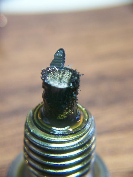

Roger Lee
Joined: 10 Jan 2006 Posts: 1464 Location: Tucson, Az.
Posted: Thu Mar 06, 2008 9:44 pm Post subject: Re: Gearbox recall |
Don't beat your gearbox up.
