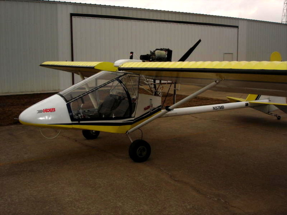

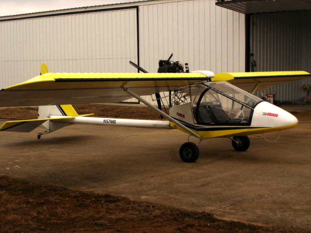

Thanks everyone for the advice on landing the Kolb. I intend to get a few hours dual instruction before venturing out on my own.
Per request, here is a pic of my "new" bird:
Joe:
Where is your center section?
Kolbs were designed to fly with centersections to cover the area between the
wing sections. They fly much better with center section installed.

after seeing the Kolbs on Barnstormers that is the one I thought you would have purchased thinking it wasn't to far from where you live it sure looks like a nice one I hope you have many hours enjoying flying in it

Is That a 582 on yer Bird ?
