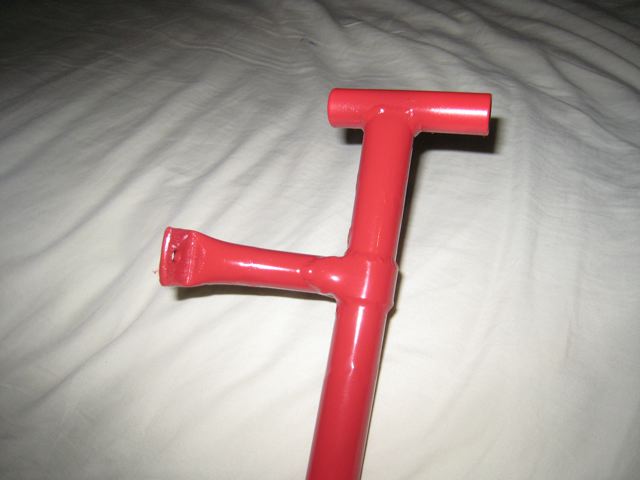

Now you'll notice that neither says what to do. Various
reinforcements have been used. Mine consists of tube width straps
wrapped around a tube then along it's perpendicular mate about two
diameters. This strap is welded all around. I'll send pictures tomorrow.

Guy Buchanan
Joined: 16 Jul 2006 Posts: 1204 Location: Ramona, CA
Posted: Fri Apr 25, 2008 7:40 am Post subject: Model 2 rudder pedal SB |
At 08:17 AM 4/24/2008, you wrote:
| Quote: | Do I need to reinforce my rudder pedals, and if so, how do I get a
copy of the procedure?
Jeff,
Attached please find a picture of my rudder pedals.
Guy Buchanan

Michel
Joined: 10 Jan 2006 Posts: 966 Location: Norway
Posted: Fri Apr 25, 2008 10:48 am Post subject: Model 2 rudder pedal SB |
| Quote: | From: Guy Buchanan [bnn(at)nethere.com]
That's not a pedal, Guy! That's a piece of art!

Guy Buchanan
Posted: Fri Apr 25, 2008 2:36 pm Post subject: Model 2 rudder pedal SB |
At 11:44 AM 4/25/2008, you wrote:
| Quote: | That's not a pedal, Guy! That's a piece of art!
I'll pass it along to Bob. He'll be pleased. (Re: picture of rudder pedal.)

Jeffrey Dill
Joined: 23 Jul 2007 Posts: 52 Location: Pleasant view, TN
Posted: Mon Apr 28, 2008 3:51 am Post subject: Re: Model 2 rudder pedal SB |
I have been unable to get the link for SB #47 to work. Thanks for the pictures of welded strengtheners. My memory is of a riveted plate, which I can do myself. So I guess I am still looking for a copy of the original Skystar SB#47.

crazyivan
Joined: 25 Aug 2006 Posts: 62 Location: Pensacola
Posted: Mon Apr 28, 2008 4:38 am Post subject: Re: Model 2 rudder pedal SB |
Jeff,
The hyperlink is incorrect. You need to remove the ending period from the address so the last digits of the address read "...Letters.htm"
My experience is that the tubes don't fail without notice. They will begin to crack a little and the crack will spread with use. Problem is that the crack on my pedal was on the side facing the firewall so a visual preflight inspection was not sufficient to find the crack. The A&P performing the annual found it.
I suggest that if you continue to fly your Model 1, 2, 3, 4, 5 then you thoroughly feel around each welded joint during preflight and get an inspection mirror to look behind the pedals.
