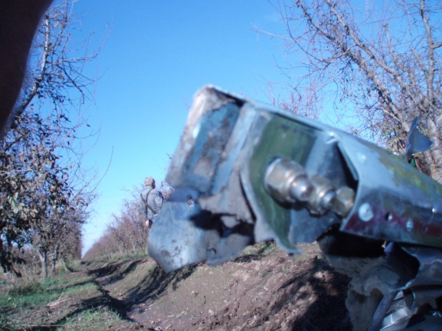

I have been looking at the photos for two days and two of them seem significant to me after Sabrina mentioned the extra threads. I have to give Sabrina another gold star because it is a good catch.
Photo #28 shows the longer bolt which appears to be located on the outboard side and on top of the center spar (near a pilot's left knee). What Sabrina noted about the bolt threads is obvious to me but what took me a while to recognize was that there is a space between the two parts (drawing 6W4-3) where the wing spar is missing.
Key to this realization is that the missing part is clearly shown in Photo #32. I may have this wrong but I'm seeing photo #28 as the center spar still attached to the right wing and photo #32 as the mating part of left wing where it attaches to the very same bolt Sabrina mentioned. So a break did occur at this long bolt with the extra threads.
These pictures are not random - I think the photographer is thinking the same thing I am. However and I think it is important to realize that we don't know what chain of events cause this particular break as it could have happened after something else failed and even after impact with the ground as far as I know because I can't determine the debris path from the pictures.
If I am missing something or have the pictures backwards or turned around, let me know.
