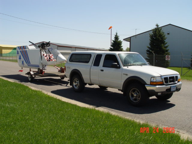

planecrazzzy Guest
Posted: Sun May 11, 2008 2:24 pm Post subject: Re: Length of the MXIII |
In this case.... Length " doesn't " matter...
Gotta Fly...
Mike & "Jaz" in MN

Dwight
Joined: 21 Feb 2008 Posts: 12 Location: Illinois
Posted: Sun May 11, 2008 3:07 pm Post subject: Re: Length of the MXIII |
| planecrazzzy wrote: | In this case.... Length " doesn't " matter...
Gotta Fly...
Mike & "Jaz" in MN
Tell that to your girlfriend ;^)
Seriously, how much tongue weight is on your trailer with the plane in place?
Looking at the bottom picture, it sure looks like most of the weight is way back and could make the trailer unstable, wagging at speed. How does it tow?
Dwight
