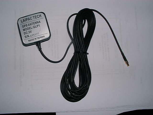

I have 2 GPS antennas to install, one is for my Trutrak ADI and the other
for the GRT - EFIS, both having internal GPS.
I attached 2 pictures of one of them, they are similar, both use a thin
cable (less than 1/8" outer diameter) and a miniature brass connector.
Since we must always seek to save some weight in our birds, I have 2
questions:
First question, which is probably dumb, but here it goes: can I install only
one antenna and T the cable for both devices?
Second question: if I want to get rid of that much cable length, can I cut
it somewhere in the middle, remove the unnecessary length, and reconnect the
cable ends? If yes, how do I do it?
Or is it better to forget the existing connector, cut the necessary length
and use a new connector? In this case, where can I find these miniature
connectors and is there a special crimper for these?

echristley(at)nc.rr.com Guest
Posted: Mon May 12, 2008 7:36 am Post subject: GPS antennas with miniature connector |
Carlos Trigo wrote:
| Quote: | Listers
questions:
Yes. You'll just have to fly much closer to the satellites in order to
get sufficient signal strength to get a lock. Remember that those
satellites are REALLY far away (22,500 miles ?), which means your
receiver has to capture a very weak signal. Cutting the received signal
in half isn't going to be helpful.
| Quote: | Second question: if I want to get rid of that much cable length, can I cut
That can be done, but you're trading a crimp done constantly by a
machine that has some semblance of quality control for a one-off job
done by someone that (so far) doesn't even know which crimper to use.
You could eventually do a better job than the machine. The question is
if the weight savings are worth the expense and effort.
I suggest you weigh that 1/8" cable and then decide if it is worth your
effort. I you think it is, then try splitting it then see how many
satellites it the receiver will lock onto. The ones to watch for are
the ones on the horizons, as they will be giving the weakest signals.

simon(at)synchronousdesig Guest
Posted: Mon May 12, 2008 9:16 am Post subject: GPS antennas with miniature connector |
| Quote: | First question, which is probably dumb, but here it goes: can I
install only one antenna and T the cable for both devices?
Carlos, GPS satellites transmit very weak signals, and most GPS receivers
are designed to get as much signal strength as possible for best
reliability. Putting a T between the antennas and the receiver will
guarantee failure or at best, lousy performance. By the way, GPS
satellites are not 22,500 miles out. That radius would put them in
synchronous orbit with the TV and other satellites. Instead, they are
12,500 miles out and orbit north to south. The transmitters' output
powers guarantee weak signals by the time they make it into our
atmosphere. The best solution is to provide a dedicated GPS amtenna for
each receiver.
can I cut it somewhere in the middle, remove the unnecessary
length, and reconnect the cable ends? If yes, how do I do it?
necessary length and use a new connector? In this case, where
can I find these miniature connectors and is there a special
crimper for these?
Again, any tampering with the cable between the antenna and the receiver
will introduce attenuation. There is a good solution here, though.
Instead of cutting it in the middle, just cut it to length and then place
the same type connector on the cut end. You may have to buy special
tooling to do this, but if you really want to do it and you do it right,
you will not suffer signal degradation. All connectors introduce some
degradation, but all you're doing is moving the degradation from N feet
out to N/2 feet out.
Simon Ramirez
Oviedo, FL USA

mprather(at)spro.net Guest
Posted: Mon May 12, 2008 9:53 am Post subject: GPS antennas with miniature connector |
Aren't many GPS antennas active (amplified, powered)? If so, it should be
possible to design an impedance match circuit from the output of the
antenna to the input of the two receivers. It's also possible that the
output of the amplified antenna is robust enough to not require any match
circuitry for adequate performance...
Matt-

jdubner(at)yahoo.com Guest
Posted: Mon May 12, 2008 10:09 am Post subject: GPS antennas with miniature connector |
On 05/12/2008 09:14 Carlos Trigo wrote:
| Quote: |
Can somebody else please indicate me a way of getting rid of those 2 useless
coils of GPS antenna cable?
Carlos,
I had a similar dilemma a few years ago and decided to retain the
connector rather than install a new one. I cut the cable near the
connector, cut the antenna end of the cable to the desired length, and
spliced the two pieces of the cable back together. This is also a
viable technique if you need to "temporarily" remove the connector for
cable routing through a small conduit or to lengthen the cable.
The pundits will tell you that you can't splice this coax as it carries
a very weak 1.575 GHz signal but I never noticed any degradation in the
performance of the GPS.
Of course, I paid attention to detail in the splice by keeping the
splice length to a minimum, re-insulating the center conductor well, and
then restoring the shield coverage to as near 100% as possible.
Best,
Joe
Long-EZ 821RP
Lewiston, ID

nuckolls.bob(at)cox.net Guest
Posted: Mon May 12, 2008 10:46 am Post subject: GPS antennas with miniature connector |
At 03:04 PM 5/12/2008 +0100, you wrote:
| Quote: | Listers
questions:
No, for a couple of reasons. One is that this antenna . . .
http://www.laipac.com/ant_GLP1_RA_eng.htm
is a powered device that gets its operating voltage from the
associated GPS receiver. Mixing two receivers onto a single
antenna offers some system integration as well as some
system reliability (single point of failure for both
receivers) issues. Recommend you stick with dual antennas.
From the photos, I deduce that your antennas are fitted with
the SMB series connectors. But these come in several styles that
include screw on and push-on. It looks like you have the
push-on style.
http://www.aeroelectric.com/Pictures/Connectors/Coax/SMB_push-on_1.jpg
http://www.aeroelectric.com/Pictures/Connectors/Coax/SMB_push-on_2.jpg
http://www.aeroelectric.com/Pictures/Connectors/Coax/SMB_push-on_3.jpg
Digikey sells these connectors but a quick look for tools
did not produce any hits.
The task of shortening these cables is trivial
for anyone with the skills, tools and connectors. You
may be able to find someone locally who routinely works
with these connectors and get the job done.
However, keep in mind that the antenna assembly's performance
IS BASED on the as-supplied condition . . . meaning that it
will perform as advertised with the long cables. It's
doubtful that you'll improve on that performance in any
way that you can perceived so this leaves you with the
goal of shortening the cables because it looks better
and saves a little weight.
Obviously we need to leave it to you to deduce the
trade-off for accepting the costs and risks for a
DIY cable shortening effort and the return on
investment for achieving a slicker looking installation
and a few ounces of weight.
My best recommendation is that (unless you can find
some local support in skills/materials/tools) you
leave them as supplied.

If his GPS antenna is powered by the receivers, then a T no doubt will
interfere with that function, as DC doesn't pass through transformers. If
Carlos can give us more details pertaining to the specific antenna and GPS
receiver models, then his problem can be analyzed further.
Joe Dubner earlier said he spliced his GPS antenna cable in the middle,
and it performed well. I am surprised, but I've seen stranger stuff
happen. I'd rather remove the connector, cut the cable, run it through
the small opening, and reinstall a new connector.
Simon

Right.. You'd have to admit though that it wouldn't be rocket science to
make 5VDC available to the antenna - from the antenna side of the matcher.
Then again, I'd likely try to find antennae that's smaller/lighter, and
with shorter cables..
Matt-

I admit it is not rocket science to provide DC voltage if you have the
source and delivery system for it. In Carlos' case, though, I believe his
goal was to squeeze nano-tons of weight out of whatever he was doing, and
an additional wire from one receiver or power supply to the antenna would
defeat this purpose. He might as well stay with the extra cable length.
In an earlier email, Bob said that two receivers supplying VDC will
introduce further complications, and one antenna feeding two receivers is
a single-failure point. These two statements are valid. If two GPS
receivers were going into my airplane, I would have two separate antennas.
Of course, I'm not as worried about weight as Carlos is either. I know a
guy who wants to cross the Atlantic in July and August, and he's in the
same "bloat."

OK, I surrender. I will use 2 antennas and keep those lengthy cables.
A 3 month diet will save weight on myself, which seems easier (apart from
being better for my health).
Thanks to everybody who answered.
