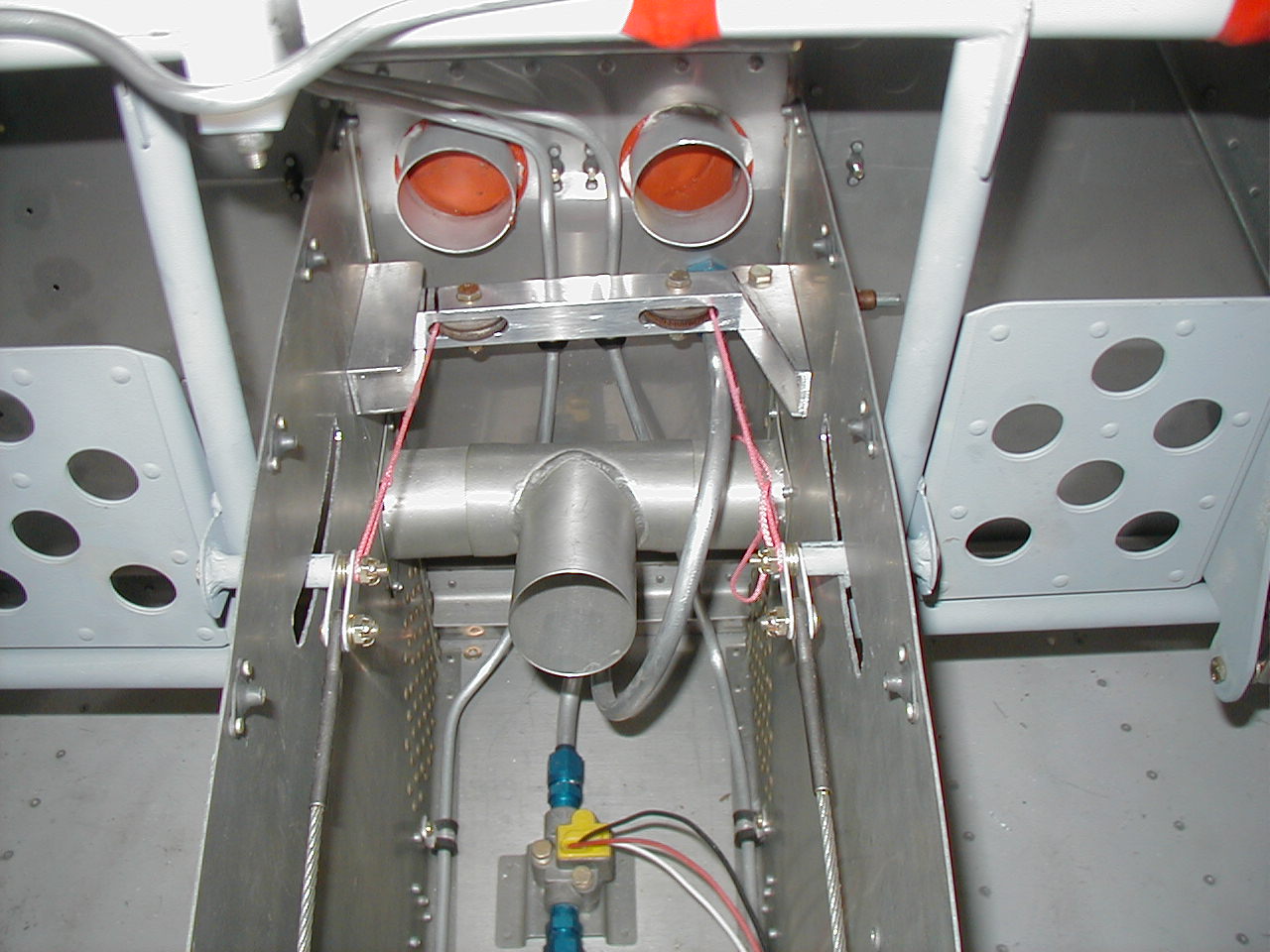

Here's a pic of the bracket I cobbled up for the closed loop rudder cable. The red string is where the 1/16" loop cable will go. The reason for 1/16" cable is that I had the pulleys already. It would be an easy mod to put larger pulleys and larger cable.
You can see the mod I made to the rudder cable attachment ..... it's inside the tunnel. I don't like sandy (in FL) shoes smacking the rudder cables so I moved them inside the tunnel. It would be simpler to make brackets for the pulleys and put them on the outside of the tunnel, running the cable through the tunnel just under the heater valves.

Thought you should also know.
The reason for the cross arm holding the pulleys is that I was concerned
with pulling the sides of the tunnel inwards if the pulleys were just
mounted on brackets ...... (which would also be needed if the pulley
brackets were on the outside). The pivot on the right side allows me to
adjust the tension by moving the left side.
I could always preload the loop with an extension spring between the
loop cable and one rudder pedal attach point. That way I could bolt the
left side down like the right side. Work in progress.

Interesting design.
Have you considered the lever arm force on the tabs holding the extensions to the rudder cables when the rudder hits the stops or just the repeated forward and back pressures from the rudder in flight. Could a small amount of continued flexing eventually break the tabs? The force on the tabs is now torque rather than tension. Just my humble observation.
