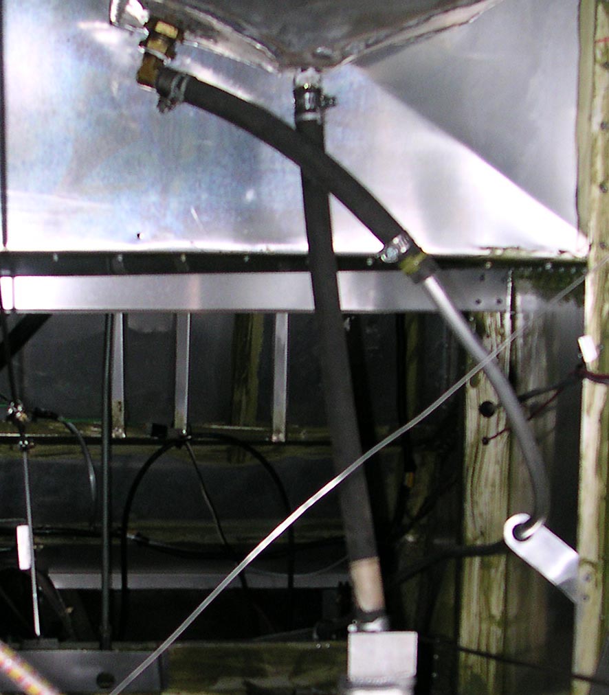

The shape of the collector is important. First the tank only holds 8.5
litres and is high and narrow so when it starts to empty the two fuel level
warning switches at the top activate promptly to announce 30 minutes fuel
left. To enhance this feature the warning switches are located in a ridge
across the top. The bottom of the tank is conically shaped to form a
sump/gascolator connected to a drain on the bottom of the fuselage. The fuel
feed with a finger screen attached is 2"off the bottom to minimize picking
up debris/water. It uncover with about 1/2 litre remaining in the collector.
The front of the tank has the wing feed connection and a sight gage with a
black cork float to monitor the depletion of the last 8 litres available.
Finally the top ridge has one of the warning switches (the other is on the
right top side) and the connection for the vent which connects to the top of
the right wing tank. (I've attached a couple of photos of the tank and its
location).

Thank you for the info and pics. This is similar to what I was thinking of. My version came from the Brazilian STOL site, but the added volume of your "fuselage ?" tank with warnings and quasi gasolator is a better idea. A little known safety margin and added range, depending on size of tank, I was thinking 3 gallons and about 1/3 gallon left in sump when port to pump is uncovered.
Let me know but I think picture that I'm attaching is pretty close to what you have.

This is a pic of a highlander sub-tank. It has two inputs from the wing tanks on top and one on the bottom. There is no vent to the wing tanks. But it is a carburated engine so the pump is not returning fuel to the tank all the time.
Kevin
