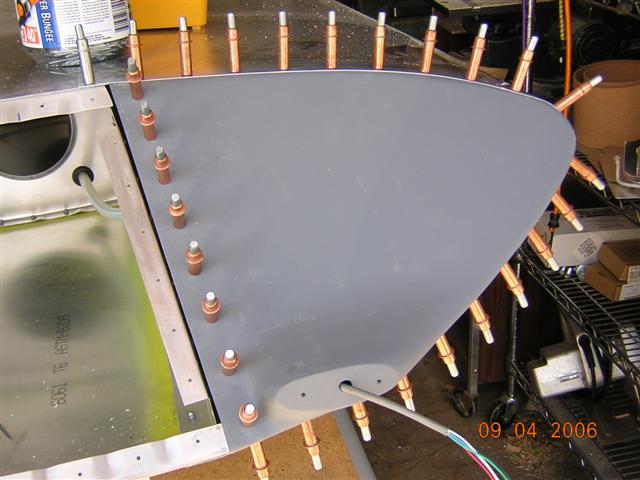

<?xml:namespace prefix="v" /><?xml:namespace prefix="o" /><![endif]--> Dave,
I have installed the Kuntzleman Combo nav/strobe lights on my wing tips and I had the same questions. I solved the problem by making custom fiberglass wingtips that move the light back so that the wing won't block the white light. See attached pictures.
Herb

Hi Terry,
Thanks for the pics. I agree that it looks like they would be easily visible from the rear on the Jabiru, but I think the Jabiru wingtips are a lot more squared off than the 601XL. With the 601XL, the light pads appear to be ahead of the outermost curvature of the wing. I came across some notes I took last year when I was at AirVenture, where I had determined after looking at completed 601XLs that I would probably need a light in the tail. I may ask at the ZAC booth to see what they say, but right now I am thinking about getting the Kuntzleman triple magnum system, which now has an optional round tail light with a white LED and strobe combination. It may not quite fit in the existing fiberglass fairing, but I am thinking about making a custom fairing myself, (Jeff Small provided details for how to do a fiberglass mold and layup). Besides, I like the idea of a third strobe – you can never be too visible to other traffic. I’ll decide when I am at AirVenture in 2 weeks.
Dave

Hi Dave
A couple of picts of combo lights. I was at the Arlington Flyin today and
noticed the lights on the Jabiru LSA A/C. They are the GS-Air/Kunzleman
variety. Take a look at the attached photos. If they are legal on the
Jabiru, I cannot believe they could not be mounted with at least as good
rearward visibility on the 601XL.
Terry [quote][b]

Ron,
Can I ask - did you use the stock ZAC supplied wingtip structure, including the fiberglass fairing / light pad provided in the kit? I could certainly be wrong, but when I looked at that structure from behind, I could not see how the light would be visible from behind no matter where it was mounted on the light pad of the fiberglass fairing.
Dave

Gentlemen, I have just used a CAD system and drew up what you are trying to do.
It works with lots of clearance if the lights are at the furthest point out
and as high on the wing tip as you can get them. I also made mine perpendicular
to earth so there will be good coverage above and below. I am using the AeroFlash
units but the solution is still the same.
FYI [quote][b]

Posted: Sun Jul 13, 2008 6:01 pm Post subject: Re: Kuntzleman Streamline Combo Nav/Strobe Lights On 601XL |
I'm not using the fiberglass wing tips but if it, the light base, protrudes beyond the furthest and highest outboard point of the wingtip, you will have great light coverage.
Hope that's clear, I know what I mean anyway, do you?
