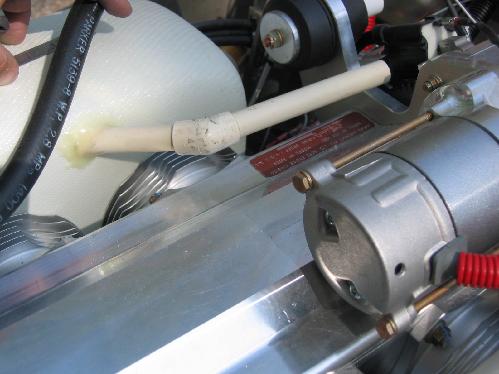

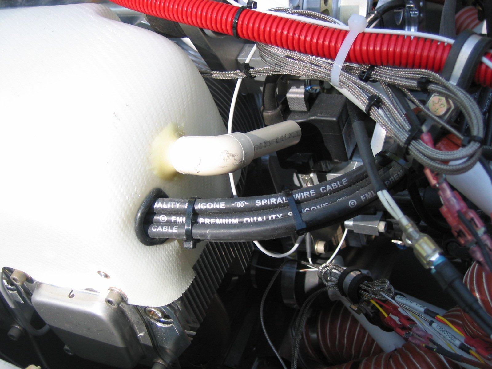

Jabiru USA told me to glue in PVC water supply pipe. It is working pretty well so far after 23 hours of flight test.
Good luck,

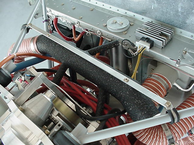

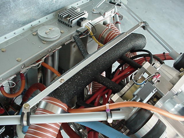

An option to tubing is 1/2" blue line cold water pipe available from the aircraft parts department in your local Lowes,
Lots of good ideas coming at you Jeff. If you want to get a bit more complicated, and direct cool air on other electricals, you could do this. Blast tubes to both coils, both mags, and the regulator. Fed from NACA vent on bottom of cowl.
tailwind jeff s.
