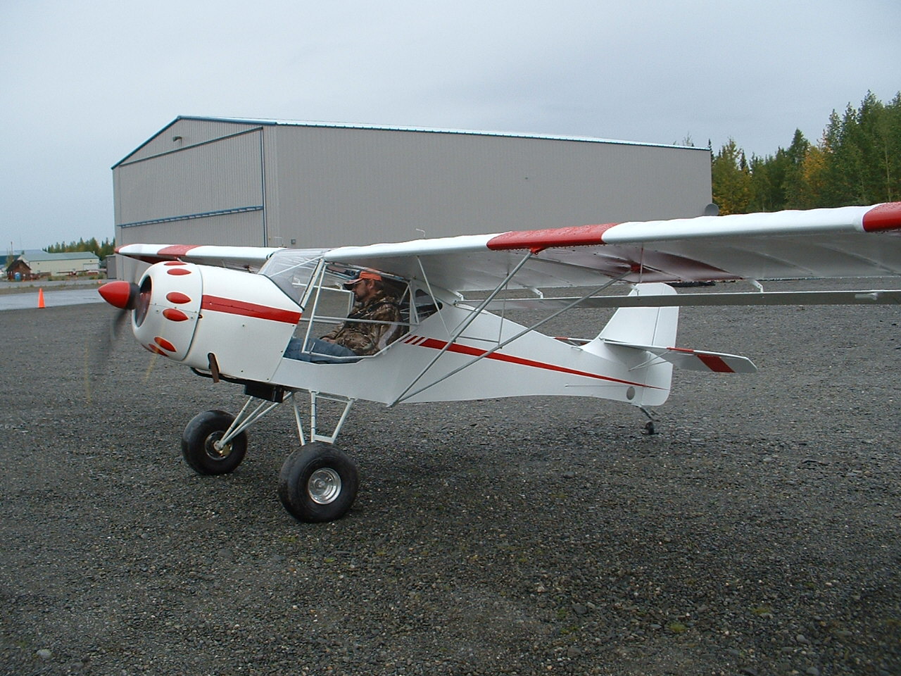

well after a year long re-build, KF 92DR took to the sky's once again on 9-12-08. First flight was uneventful and she flew very nice. Second flight got hairy when I lost the left brake on roll out.... good thing it was raining and the runway was wet or it could have been ugly. As it was I ended up doing a ground loop at about 10 MPH.
The plane is owed by a buddy and he did the re-build, I just got the honors of doing the "maiden". Nice job Bob, Now get busy on the Model III !

That landing gear looks wider and higher than the original. Is it that the one sold by Airdale? By the way, the plane looks great!
Jose
Yes that is the wide gear from Airdale.

How the handling compares with the standard landing gear?
Jose
Night and day difference! the wide gear is MUCH better, and with it being taller, you can get in the air quicker and land slower.
Kitfox is coming out with a wider and taller gear that has PA-18 looks to it. No more bungies from what I saw. I would be very tempted to get that gear if I had not allready bought the wide gear for mine from Airdale.
