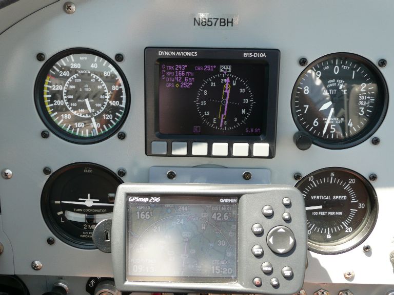

I have it and yes it works great! Not real hard to connect, you'll have
to tee into the pitot and static lines, and run a few wires (not 25).
You can see how I have mine in my panel in the attached pictures. The G
meter is just an option that is available and does not require any thing
extra to install. The second picture I attached is the optional screen
you can bring up if you have a Garmin GPS wired into it.

robertrv607(at)yahoo.com Guest
Posted: Thu Sep 11, 2008 10:37 am Post subject: Efis Question |
Bobby : Again thanks for the reply.. have a question, do you have any schematic
drawing shoing the wiring, the way you did it?
It would be a great help to see how it is done...
thanks
Bert
thanks
Bert
Dynon installation manual with all wiring schematics and pinouts can be
downloaded here:
http://www.dynonavionics.com/downloads/Install_Guides/EFIS-D10A%20Installation%20Guide.pdf
In particular see section 2, "Wiring Overview".

Sam: Thanks for the info. One question, when I make the harness, at least I
hope I can,,, hate to pay $200 plus for one....is better to use all the pins,
that is connect all 25 wires, even if I do not need them... or should I save myself
a lot of work, and use only the minimun required.. to connect the unit....
your suggestions will be appreciated as always.
downloaded here:

bert murillo wrote:
| Quote: | Sam: Thanks for the info. One question, when I make the harness,
at least I hope I can,,, hate to pay $200 plus for one....is better
to use all the pins, that is connect all 25 wires, even if I do not
need them... or should I save myself a lot of work, and use only the
Bert rv6a
Bert, I would use only the pins necessary to make the connections you need.
Sam Buchanan
