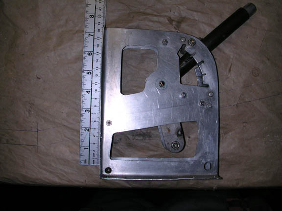

Posted: Mon Oct 27, 2008 8:39 am Post subject: 701 Flap Angle choices |
Built my 701 in 94 to plans (1/91 -#2226) three notches; UP, 15', 30'..I had
just retired from the Air Force and last experience was fighters and 2.5"
glide slopes. Needless to say getting use to the 701 on approach with power
OFF was traumatic. I eventually got to practice full flap landing on wheels
after about 15 hrs even did a few with power OFF.
During the first 100 hrs I was not too crazy about using full flaps; I did
not believe they helped much on TO or landing. I mainly used the 15' slot.
By then I was on floats and eventually learned that full flaps shortened the
TO by a significant amount. I won't elaborate but it has to do with the fact
that floats prevent rotating to a high angle of attack and therefore the
extra lift from the flaps is a bonus. I now use 30' at all time except in
strong gusty winds and raise to 10' in ground effect after TO.
I found the ZAC flap lever design awkward so made my own (pic attached. with
5 notches, UP, 10', 20', 27', 37'. . I have used the 5th notch a few times
but eventually locked it out with a bolt. Anything above 30' can be
dangerous because it limit role control. With the flappers down much above
30', any further deflection for role control risk stalling the down going
flapper thereby introducing control reversal. Control is possible using
small aileron inputs and aggressive rudder but the benefit of 37' of flaps
is questionable.

achieved; the flappers should not be pitching the nose down and the
stab/elevator pitching the nose up or vis versa, that's a speed brake and
not needed in a 701.
Carl
