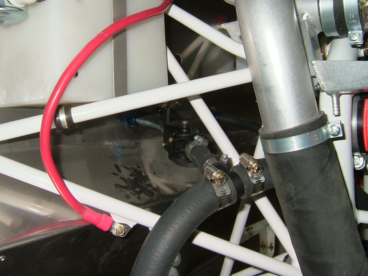

darinh
Joined: 20 Apr 2006 Posts: 327 Location: Utah
Posted: Fri Oct 31, 2008 10:03 am Post subject: Re: cabin heater |
My cabin heat comes from the same setup you have but uses two fans. It puts out some serious heat...enough that I can usually just run the hot coolant through the heater core and don't even need to run the fans (this is down to about 40 degrees F ambient). When it gets colder, I run the fan for 30 seconds to a minute and that is good for awhile. I think I will put the switch for the fans on a potentiometer so I can vary the speed, that way I won't have to turn it on and off. I also but a cable actuated shut-off valve in the supply line so I don't get cooked in the summer months.

darinh
Posted: Fri Oct 31, 2008 8:49 pm Post subject: Re: cabin heater |
Pat,
I got the shut off valve and cable from Napa auto parts. I don't recall the part number but it was a stock item and I went through what they had until I found one that fit. It simply closes the heater circuit when shut. So far it has worked like a champ.

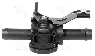

Posted: Sat Nov 01, 2008 9:06 am Post subject: cabin heater |
I think the shut off valve from Napa ($20?) is probably # 6601141 5/8" with the cable in-line to the hose. Kragen Auto # 74627 sells for around $15. You can see pictures on their Web sites.

darinh
Posted: Sat Nov 01, 2008 11:38 am Post subject: Re: cabin heater |
I couldn't find the Napa part # on their website but the one listed on Partsamerica.com (#74627) is the exact valve I used. Here is a pic of it from their website and a pic installed in my bird. The supplied 1/2" coolant hose took a bit of coaxing to get over the 5/8" barbed ends of the valve but with a little lubricant they will go on.

msm_9949(at)yahoo.com Guest
Posted: Sun Nov 02, 2008 5:48 pm Post subject: cabin heater |
Saved from a previous post:
1970 Doge Truck heater valve Napa part # Bk 6601141 $20.00 5/8 hose size, in-line cable operated. Kragen auto parts # 74627 $13.00
