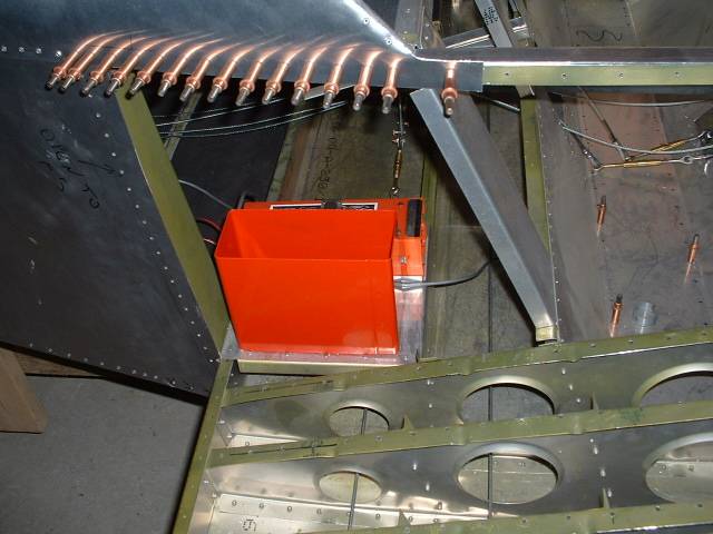

Posted: Sun Nov 02, 2008 8:33 am Post subject: D100 compass |
Dred+All-
Unlike the XL, the HDS doesn't have a hatch near the tail. Everything's all buttoned up and I'm not going to tear the fuse top skins off or try crawling back to the tail.
One of the listers who has 200+ hours on his system installed his unit behind the passenger seat. The tray I built for the passenger side is occupied with the battery and ELT. At the same time I built the passenger side tray I built one for the pilot's side, originally intending to mount a tool box on it. I decided against it and tore it off, because the only thing gaining weight faster than I am is my project. Pictures attached for the guy from France who wanted to see some installations.
Luckily, I haven't visited the scrap yard recently so my pilot's side tray was still around. I just stuck it in position for the picture- I'll cut it down to fit the compass unit.
One question for all D-100 owners- how did you determine if the base unit and the compass are mounted within plus or minus 1 degree of each other? I assume this is in the roll axis.
Bill

I built my mount for the remote compass yesterday. I"m mounting well back in the fuselage aft of the large access panel.

“how did you determine if the base unit and the compass are mounted within plus or minus 1 degree of each other?”
Use a digital level.

| craig(at)craigandjean.com wrote: | “how did you determine if the base unit and the compass are mounted within plus or minus 1 degree of each other?”
I did the same. Assuming that the plane is built to specs the panel and the Dynon box will be level when installed.
The mount I built for rear fuselage installation had to correct for the 3 degree tilt of that area.
