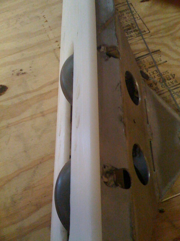

Attached are a few more pictures of my skis for those of you that are interested. My memory is a little flawed. Earlier I stated that my skis are 12" wide. After I took these pictures a couple days ago, I checked and in fact they are only 10" wide. My bad. I think the "sometimers" is setting in.

What is the frame made out off, looks like 1/4 plate?

The frame is made from .125" 6061 T6 aluminum plate. I made 4 revisions to the prototype before I got the design right. It still may not be right, but they seem to work.

What did you use to get the curved up front of the ski... and how high does it come up? Looks like it is 2-3" only... seems kind of low!

It is only about 3" high.
I used a garbage can lid to trace an arc to a piece of wood that looked about right. I then took the wooden template and traced it to one side of a piece of aluminum angle that is the ski portion of the frame. I cut the piece out, then bent the bottom of the angle to match the arc and welded it. It could be low, but other store bought skis are about the same. I then cut the scrap off, and welded a cross piece in.

What size is the angle... looks quite heavy? Do you have any more photos?
