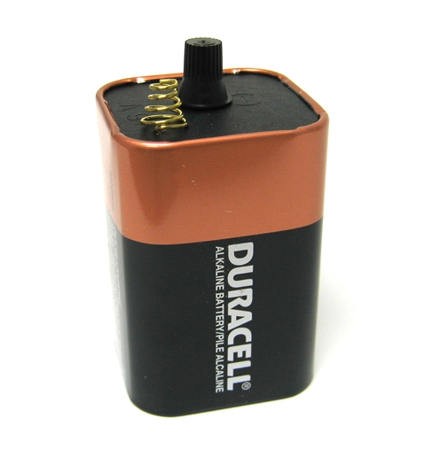

We need to do the stand-alone battery test to
make sure the offending noise is coming in through
the power supply. If the noise is coming in through
another path, then a power filter wont help.
You can use a couple of 6v volt lantern batteries
in series. Do your stores carry these?
[img]cid:7.1.0.9.0.20090102080952.01ed7d50(at)aeroelectric.com.0[/img]
It doesn't need to be alkaline. The venerable old
carbon-zinc versions (cheapest) would suffice for
this task.
Bob. . .
