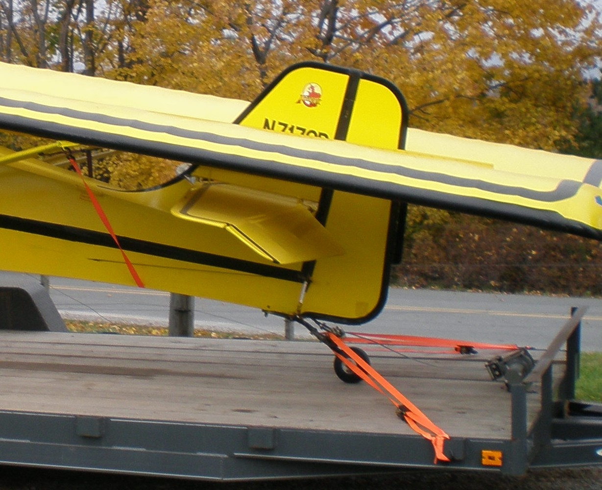

Posted: Sat Jan 03, 2009 6:43 am Post subject: Trailering a Kitfox |
These questions are best answered if you give us a bit more information
James (I assume is your name?). I trailer my Model 2 all the time on a car
trailer and also have the original Denney-supplied tow kit. As I understand
from posts on this list different models have very different towing
requirements.
To start you off I have attached a picture of my KFII tail section ready for
the road, speeds up to 50 mph but that is a self-imposed limit and I don't

This is what I have done..and found out to do..I had made..Braces out of
wood.1X4 in.and used a sleeping bag pad.cut it.and glued it in to
place.I had made 2 for the stab.,1 for each side.and 2 for rudder..I tow
my KF backwards .on trailer.and I all so tie down tail wheel real good
so it does not move at all..all so winch strap,at wing tie downs,to
trailer.but not real tight...that helps stop wind at hi way speeds from
lifting up wings.I can tow my KF at 50-60mph with no problems..but you
do not want to tow on windy days.I had built a custom trailer to haul
airplanes that I sell..I have a trailer company that builds them for
me.and then I sell them..the largest plane that I have hauled on it was
a Cessna 170.right down the inter state..you just want to make sure.to
tie the tail down tight.so it does not move around on you.all so
rudder+stab.or if you do not..the trailer will move from side to side..I
have hauled airplanes from way out west to Ohio.like this with no
problems..C120-140-170-172 tri pacers etc.I all so rent my trailers
out..Steve Shinabery N554KF

planecrazy2020(at)gmail.c Guest
Posted: Sat Jan 03, 2009 9:21 am Post subject: Trailering a Kitfox |
James,
The first photo shows the tail wheel support and the second shows the front spar brace that you will need. By the way this is not my aircraft.
David
