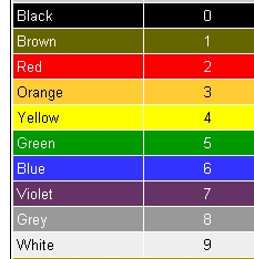

One caveat about the machined (not stamped sheet metal) pins
is that they are not interchangeable! Some submini D connector
contacts will not fir the shell of other manufacturers. Also, different
connectors pins for different wire size, i.e., 22 ga vs. 18ga.
At least for the larger circular connector series from AMP or Amphenol,
the pins are color coded with tiny bands. Of course the companies
don't make it easy to discover the color code meanings! I've never
seen a collated chart, even from a single manufacturer. If any has
such a chart, I would love to see it.

It's not a big secret. Most pins offered for military
spec'ed connectors are in the Mil-C-39029 family of devices.
In particular, the 20AWG standard density d-sub pins are
39029/64-369. See:
http://www.aeroelectric.com/Pictures/Connectors/D-Subminature/D-Sub_20AWG_Pin.jpg
similarly, sockets are 39029/63-368
http://www.aeroelectric.com/Pictures/Connectors/D-Subminature/D-Sub_20AWG_Socket.jpg
Note that in both cases, the color banding on the
pin barrel uses the legacy electronic components color
code convention shown below.
[img]cid:.0[/img]
In the case of the d-sub pins, the color bands
denote the last digits after the dash in the
full part number.
I'm aware of no cross-reference list that will
let you back into the application of some stray
pin. However, if you go to a particular connector's
specifications, the pins for each hole along with
the wire-gage range for that pin will be defined.
I'm aware of no ambiguity in 20 or 22AWG d-sub
pins for marking or application. If you have a
pin that doesn't fit the hole in a D-sub of
one brand, then it's not a d-sub pin for any
brand.

See,
That's why we post here Bob, you knew that the the color bands
index to the mil-spec part, whereas when I order from Arrow or
Jameco, or Newark, I only paid attention to the Amp catalog numbers
and the tooling / App sheets. I never noticed that the MilSpec
nomenclature was even in the docs I have!
Bravo.
