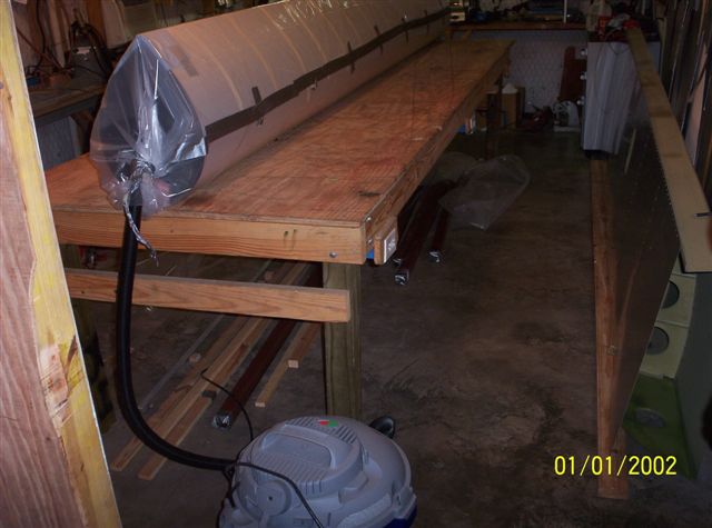

wjones(at)brazoriainet.co wrote:
Hey Dan ,I had good results using this method. Wade Jones � � � � �

--> Zenith-List message posted by: "leinad"<leinad(at)hughes.net>Wade,That's the method I was going to use, but what type of pipe did you use? Is it PVC? Do you think PVC would work?Danwjones(at)brazoriainet.co wrote:> Hey Dan ,I had good results using this method. Wade Jones � � � � � > > Note: or receiving certain types of file attachments. Check your e-mailsecurity--------Scratch building XL with Corvair EngineRead this topic online here:http://forums.matronics.com/viewtopic.php?p=226625#226625Attachments:
http://forums.matronics.com//files/100_2528_2_174.jpg< -->

I bent my Sonex leading edge skin using the Vacuum method with a PVC
pipe, worked just fine. There is no bending force on the pipe.

Ya, I did my Sonerai wing skins with the vacuum method, it works like magic.
But, be sure to have something limiting the bend radius, it works to fast to
do it by hand (I used a 2" pvc pipe)

I got one nose skin bent today. Using the vacuum method it went well. I ran out of time (had to go to a Super Bowl party) before I finished the second one. I used steel pipe, which I had to join because the longest lengths I could find were 10 feet.
THere are pictures on my web site at:
http://daniel.dempseyfamily.us/zodiac/index.html

Looking good Dan, hope your team won. Did ya get any pictures with the vacuum applied and the part totally collapsed?

I t does not look as though you drilled holes in the pipe? I drilled holes along one side down the pipes length for the stab and elevator skins. I assume that you let the vac suck out one end inside the plastic? This is interesting, because I don't want to ruin another pipe by drilling holes in it when I do my wing skin!
Kevin

No I didn't. I picked up the camera to shoot one, but just about the time I was ready to take the picture a hole developed in the plastic and let the air out. The part was already bent, so I saw no use in fixing the hole just for a picture. I'll try again next time, maybe ask for an assistant on that issue.
Dan
