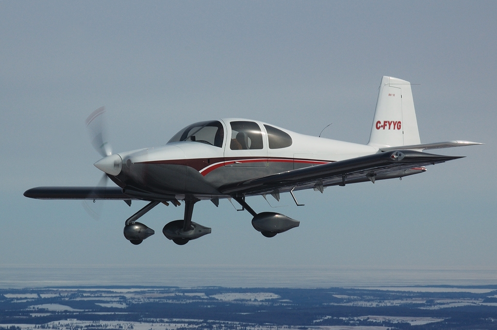

Attached is a beautiful shot of a Canadian, Three blade with the nose
wheel cant "In Cruise". This is one of over 100 fully painted RV-10s
from my database update. I always wondered how many were skewed in
flight due to low breakout force and the nosewheel weather veining at
cruise.
Maybe Mr. Corrigan could fill us in.
Tim, I missed the Break Out force numbers on the Nosewheel called out in
your Conditional Inspection - Landing Gear Section. Must be ole age on
my part cause you are soooo thorough. We have added it to RV6s which
required the mod for such things.
John Cox Flying N26XE in my dreams
