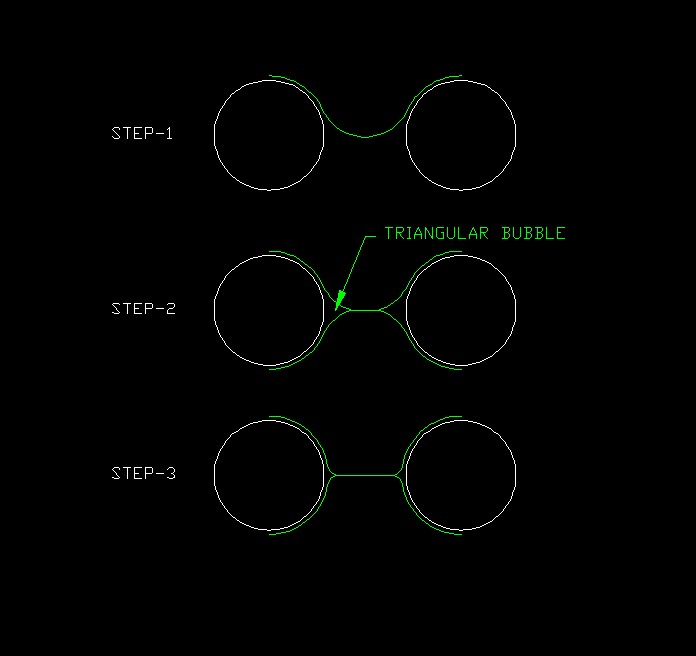

I use a 3M 3372 polyurethane surface protection tape applied on both top and bottom of the gap (previous posts shown as >-<). The tape is very tough and stays flexible for years. I recently changed mine after 10+ years of service. It was a little yellowed from the exhaust but it never peeled or lost adhesion.
I bought mine from mcmaster.com several years ago. They don't appear to list the clear tape online but I'm sure they can get it. A better deal might be the 3M 3372 tape sold by Aircraft Spruce in 12yd lengths for about $17. It appears to be the same tape I use and I *think* it might be the ski-saver tape mentioned in this post. Spruce sells different widths for protecting prop and flying surface leading edges.
http://www.aircraftspruce.com/catalog/cspages/protectiveLeading.php
I bought the 36yd roll from McMaster and found it handy to also stop chafing between the turtledeck and wing roots, chafing around the door skin and door frame, even between the upper cowl and base of windshield.
I have an Avid Mk4 and the 1" wide tape bridged the ~1/2" gap between the tail surfaces. It also comes in 2", 3", 4" widths. It has a paper peel-off over the adhesive side that can be marked with a sharpie in case one would want to trim the width with scissors. It also peels off the fabric with no damage or adhesive residue (mine fabric is painted with Stits Aerothane).
The photo shows a small section, tape on both sides of the stab/elevator, (and I see I should have cleaned the hinge before I took the photo ). BTW the tape is not cracked, it's a reflection, the tape is glossy.
Dan H.

Lynn Matteson
Joined: 10 Jan 2006 Posts: 2778 Location: Grass Lake, Michigan
Posted: Sun Feb 01, 2009 5:30 pm Post subject: Elevator Gap Seal Test Report |
That's a good-looking job, LL.

rexinator
Joined: 31 Jan 2009 Posts: 33
Posted: Sun Feb 01, 2009 8:17 pm Post subject: Elevator Gap Seal Test Report |
That's exactly what I was trying to describe with my >-< symbol and my
little drawn image file. I agree with Lynn that it's a nice job. Can
you elaborate on how you applied so well?

Lowlead
Joined: 02 May 2006 Posts: 6
Posted: Sun Feb 01, 2009 11:46 pm Post subject: Re: Elevator Gap Seal Test Report |
Thanks Rex (and Lynn)! I wish I could say that it's this consistent along the entire length of the gap, but it's not. The gaps tend to be smaller on the outboard ends due to the way the tightened fabric act on the stab and elevator frames.
Installation is hard to describe but not that hard to do. One thing nice about this tape is that it's very pliable and the adhesive is not super-aggressive at first. The tape is applied across the gap (we'll say the top side first) with a very slight 'drape' down and then firmly pressed onto the LE/TE tubes. Then the bottom side tape is applied with a very slight drape up (I used a pc of 1/4" tube to force the drape up) and then pressed onto the LE/TE tubes. The two tapes stick to one another like a champ but leaves a triangular 'bubble' running the entire length . I used a wooden tongue depressor and fingers to press the top and bottom tapes together to eliminate the bubble. (see attached). It's tough stuff and stretches well enough to get a tight installation. There's no worries about tearing or punching through with the tongue depressor.
The control surface (elevator or rudder) must be in the neutral position when tape is applied or else a tension 'bias' might get built into the installation (ex: rudder now pulls left or right due to tape..)
Hope this makes sense...
Dan H.

Lowlead wrote:
| Quote: |
Dan H.
> Rex
> Colorado M2/582
http://forums.matronics.com/viewtopic.php?p 28125#228125
http://forums.matronics.com//files/gapseal2_183.jpg
