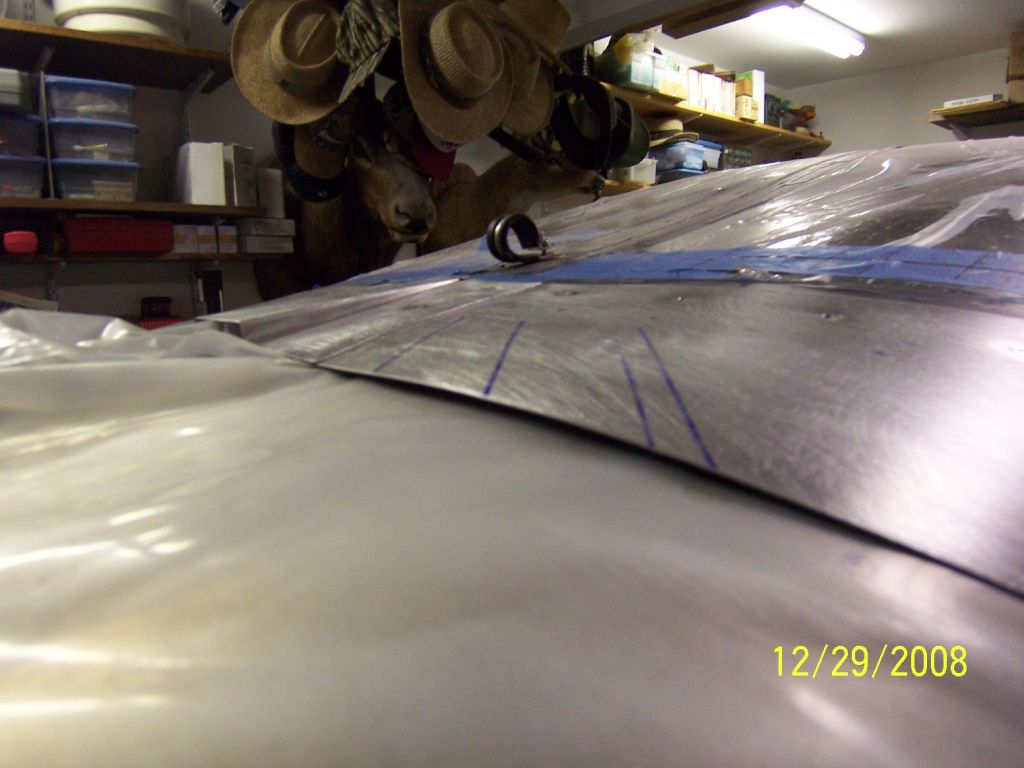

like many of the early QB RV-6's, the fit of my canopy was appauling.  Particularly at its leading edge.  Being disinclined to re-do any of that canopy work, I instead eventually 'fixed' the problem by laying up micro over the front turtledeck and on the front deck of the canopy frame.  Then just sand down until it looks like it fits better, and paint.  added a couple of pounds, but turned out OK and at least I didn't have to re-do the canopy (and potentially get the same problem all over again.

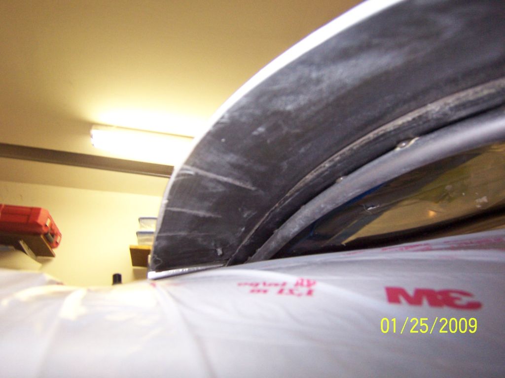

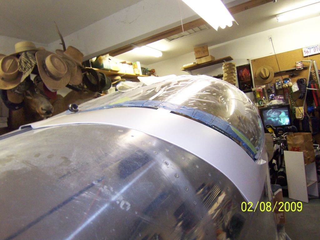

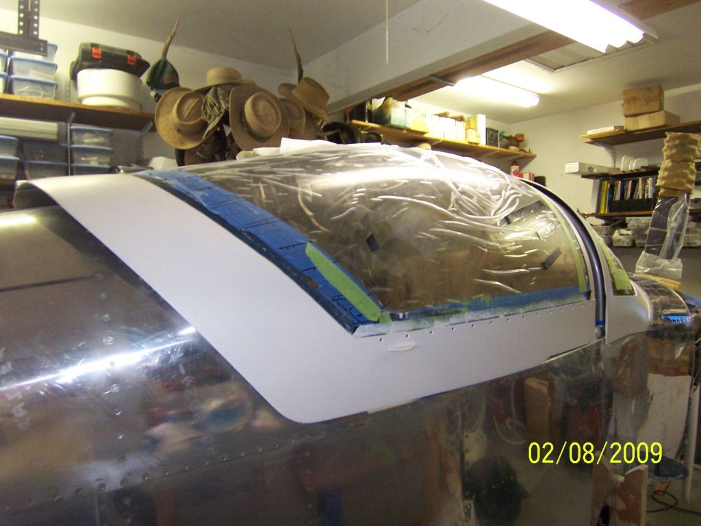

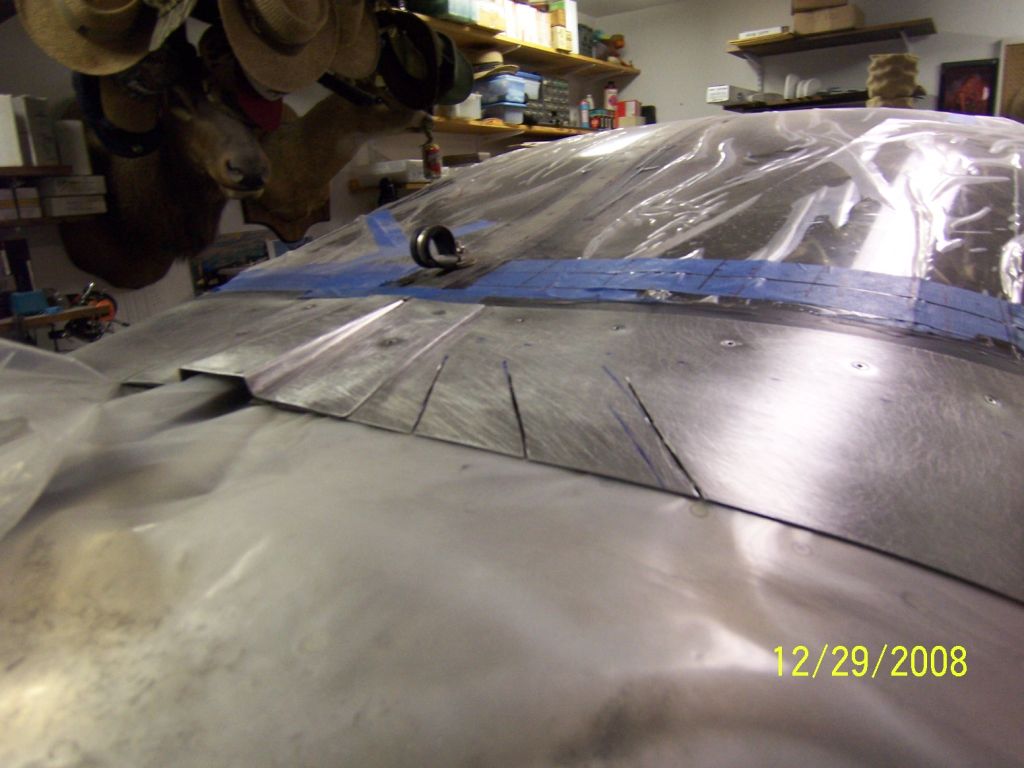

PostPosted: Sun Apr 05, 2009 7:43 pm    Post subject: canopy Reply with quote
I had` the same problem with the frame on my QB6. I did some "forming" and fiberglass buildup for the rest of the fit. It was a lot of extra work for a poor fitting frame. Never could get the rear skirt to fit nice and tight. I suspect Van's would have fired the welding shop for this frame if they had to use it on one of their planes. ??
again.

HI:
Thanks to all those who respoonded to my question on the canopy,
I should clarify that I have the Slider, and the poor fiting I have
is mainly on the sides, the rear portion...I understand the only way I could
fix this, is to remove everything and re-bend the frame..
which I do not want to even think about it..
The options some suggested, would be using fiber glass, to fill the spaces
, that would be fine, in my case the space is too large to do this,
almost 3/8..
I think if I could get a new frame, I would have to start all over..
remove everything and, put the plexi on the new frame no?\
Where can I get a frame, cheaper than, buying a new one, that is the
question.
Any how, thanks to all for your suggestions.
Bert
rv6a

bertrv6(at)gmail.com
PostPosted: Wed Apr 08, 2009 6:44 am    Post subject: canopy Reply with quote
Bill:
Thanks fo the suggestion, it is a good one, however in my case, what
happens is the frame itself, is a little too wide at the rear,
so the problem is to re bend it if that is possible now. yours look very good..
Bert
rv6a
On Mon, Apr 6, 2009 at 9:23 PM, Bill Schlatterer
<billschlatterer(at)sbcglobal.net> wrote:
Bert, this is just a thought.  There is sort of metal/glass skirt
combination that might work for you.  Before you go to all that trouble, you
might try just slotting the rear skirt where it bulges.  Cut a couple of
slots (1/16 to 1/8 wide as needed) in the skirt with a dremel tool running
at an angle to match the bulge.  This will allow you to bend individual
pieces of the skirt down to match the profile of the deck.  Should be able
to adjust/bend the side skirts a little when the pressure on the rear skirt
is gone.  Close the canopy on a plastic sheet and then lay up glass over the
original skirt covering the "adjustment slots".   Couple of layers of glass
and I think you end up with a nice looking skirt although it might pick up a
pound or two of weight as you can't just glass one part.  On the other hand,
it will sound like the door on a Cadillac when it shuts  Wink and you will
have zero stress on the canopy itself.
If that doesn't work, you aren't any worse off.  Not at all sure you
couldn't just cut off the back couple of inches of the skirt and use the
remaining part that is still riveted to the canopy as the base to bond on a
new glass skirt.
If that doesn't work, then move on to new frame, refit canopy, etc,...
Bill S
