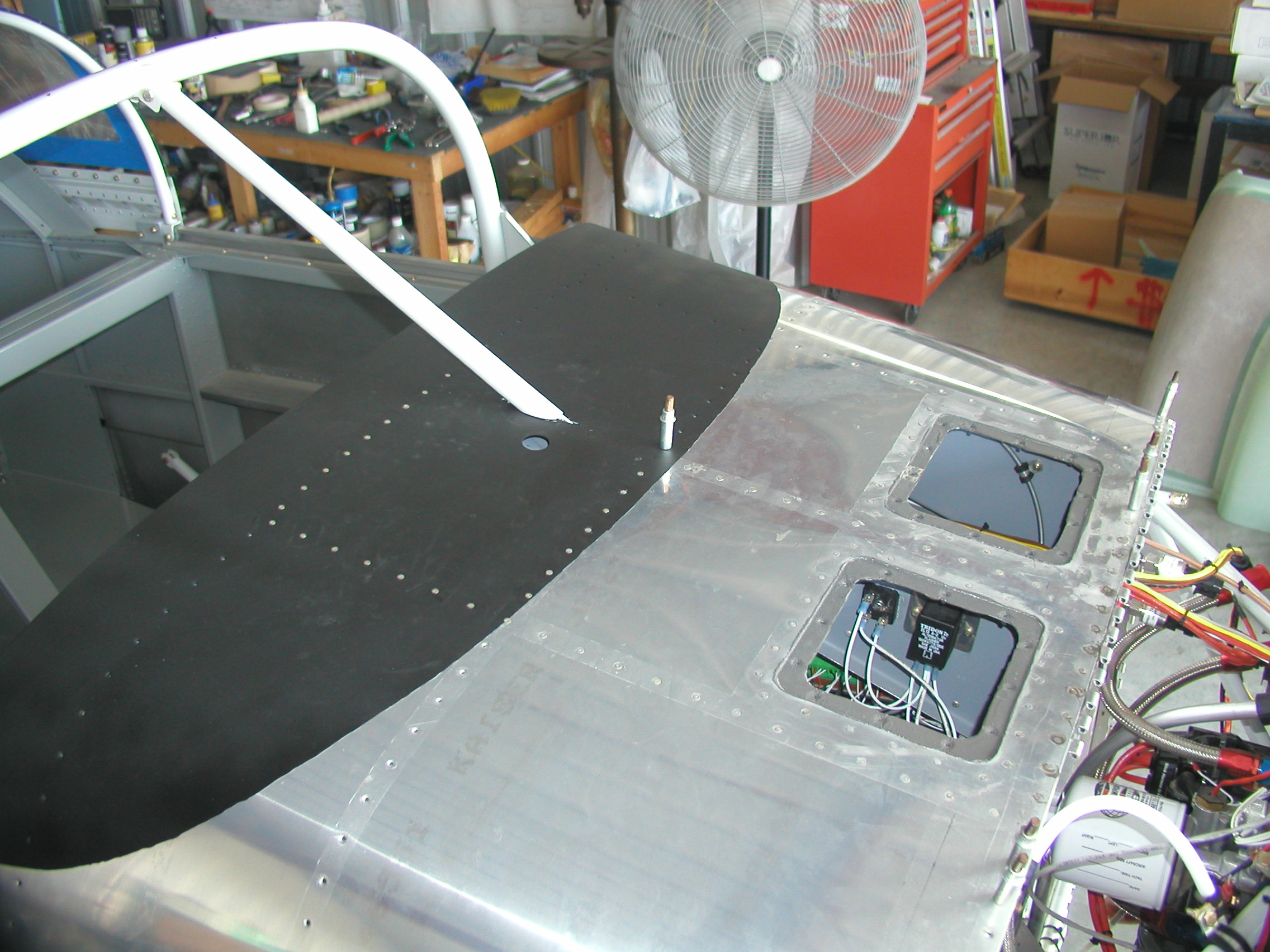

Yes I did. Yes it did leak but not after using a sealant just recently, I picked it up at the auto parts store it was not RTV but is something that does not harden, I put a small amount around it and installed it. Washed the aircraft (the only time I noticed it leak) an it did not leak.
Surfing the web from Hopkinsville, KY

For my 8A, I think I remember that I had some material trimmed off the forward top skin that had exactly the right curve in it, or possibly I rolled the curve myself. Either way, it fit the curved surface quite well.
Terry

The area in which I located the panels is very flat and so it
did not have any impact. If you build 4 inspection panels as
some have done (two additional panels outboard) then that
*might* be an issue in which case you would want to measure
and drill with the skin in-place.

Above are some notes on access panels I did on the RV-8.  No memorable problems with water leaks in during washing or flying.  Otherwise is was hangered or covered.  I may do the same on the RV-7 tip-up....not sure yet.

That sure looks familiar, Larry. I think I must have copied yours.

The only way I knew that mine leaked was because I have the brain box for my engine monitor under one of those and after I washed the aircraft my engine monitor would not work properly until it dried out. I never saw any water so it was very little. After sealing, it no longer leaks. They are very need on my plane, and glad I did it.
