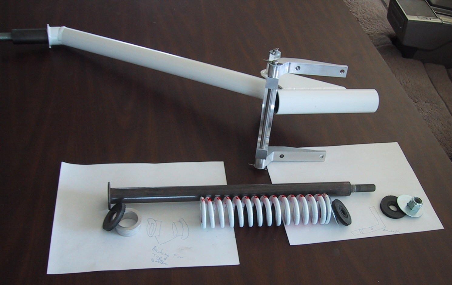

Hello Ken, Rich wrote: "........ the later spring/shock gears were not heat
treated."
Just wanted to let you know that when Lyle Hendricks converted my airfoil
shaped spring / shock nose gear strut to a round tube that it was heat
treated on 11/14/01.
It went through: Normalize at 1650 degrees; Autenitie** at 1575 degrees; and
Temper at 1050 degrees. Rockwell C hardness was 28-31.
Please see the attached picture.
