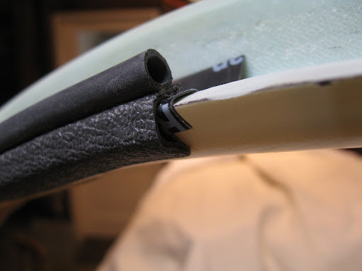

I finally decided to use the same mcmaster carr seal. in the process of trimming the door frame to make room for the seal, i was curious about what others may have done to keep the door seal in place.
you can see in the picture linked below, that it would be great to make that barb useful. the barb is located on the interior, to minimize the amount of distortion the seal makes on the door.
however, now would be a good time to find a solution to use that barb. the possible options i can think of are:
1. create a channel or lip to catch the barb. the tricky part is that the edge tapers quite a bit on the end.
2. build up a channel or lip. thus, how to build it up nicely?
3. do nothing at all and glue it in.
thus, i'm left pondering what approach the many others who have gone down this path have taken?

I was playing with some tape to simulate what a built up layer would do. It works surprisingly well. Sorry for thinking out loud here...

PostPosted: Tue Jul 20, 2010 3:06 pm    Post subject: Retaining Mcmaster carr door seal in place Reply with quote
This what I did, which I've copied from several other builders that did the
same before me.
When you trim the rain gutter, trim in square so the trim installs in the
appropriate orientation. You will have to build up portions of the rain
gutter to 1/4". The best method is to use thin strips of glass since there
are places that you'll need to build up over 1/8". So folks have just used
micro or flox, but I think using fiberglass strips will make it stronger.
There are some places where you may also need to sand a flat area on the
back side to get a good grip.
Ivan Kristensen and Geoff Combs have good photos on their sites. Ivan also
has a video showing the dimensions on his rain gutter after trimming. I've
tried pulling off the seal on Geoff's RV-10. It's almost impossible to get
off and it's not glued. He just built up the edge so the fit is very tight.
Les Kearney wrote a doc on how he did his door seals. I can forward a copy
if anyone wants it. He also filled in the rear of the seal so it's smooth
on the interior. Basically making a channel for the seal to sit in.
