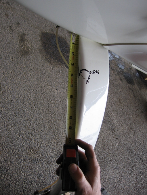

During our annual inspection we found a 1" long squiggly crack in both
of the main gear legs, 4" from the fuselage. We ordered a new pair of
gear legs today for $850. I was told that there has been only one other
owner in the USA reporting cracked gear legs and it happened to them
twice and in the same location which was the same location as I ours.
It seems like a manufacturing or design defect to me, but Doug
Hempstead assured me that it was not but all have resulted from hard
landings. We have not had any hard landings, perhaps a few
not-so-smooth landings at near gross weight, but none that I would
classify as hard landings. However, since we bought ours used from a
dealer, it had been used as a demo plane and perhaps primary training,
but not sure.
WHAT TO LOOK FOR DURING PRE-FLIGHT INSPECTION:
On LEFT main gear leg the crack occurred 4" from the fuselage on the
FORWARD edge beginning at the mold line.
On RIGHT main gear leg the crack occurred 4" from the fuselage on the
AFT edge beginning at the mold line.
Attached photos shows the squiggly crack with the beginning and end
points marked by a pair of arrow heads.
Thom in Buffalo

My original post on this subject was done from the email list rather than the web forum so the photo I attached was stripped out. I'll try posting it here again.
Thom in Buffalo

| Description: |
| Arrowhead pairs indicate beginning and end of 1" long crack. |

Upon removal of old gear legs, to install new ones, we found that there was a crack on the upper surface of each gear leg where it makes contact at the entrance to the fuselage gear leg socket. I'm attaching a photo below showing this.
I ground down the small 1" crack and determined it was only skin deep (through the gel-coat only) on both legs. However, the longer (all the way across the leg) cracks were more than skin deep. They went at least through the first layer of cloth.
THESE BIG CRACKS WERE NOT VISIBLE WITHOUT REMOVING THE GEAR LEG CLAMPING BRACKET AND MOVING THE GEAR LEG AWAY FROM THE FUSELAGE !!!
Please look for cracks at this location during your inspection. I would also recomend taking a measurement between the gear legs at the axle and occasionally check this distance to detect some sag in gear before failure. This should be done at the same weight on each check. We are now doing it with the main tank full but no occupants. If this distance gets larger, it could be an early warning of impending gear cracks or complete failure.
My Opinion as to cause:
It appears that when the gear leg flexes, the stresses are concentrated where the leg enters the fuselage gear socket, partly because there is a relatively sharp edge where they come into contact with each other. In my opinion, there should be a gap at this point so the leg can flex some before coming into contact with this relatively sharp edge.
I am not a structural engineer but a retired mechanical design engineer and this looks like a problem area to me. I have an idea of how to fix this but won't post it here because I don't want anyone thinking that I am redesigning the Allegro and I don't want any liability for others actions based on my ideas. You can blame the lawyers for this.
PLEASE INSPECT YOUR GEAR LEGS at the fuselage entrance point.
