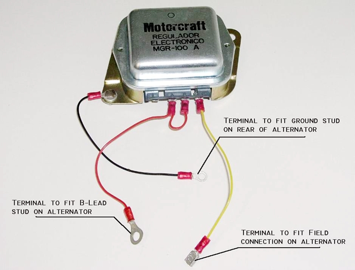

an externally regulated alternator, then
do the experiments described in the B&C trouble-
shooting procedures for LR3. Or you can add a
field voltage sense lead as described in Note
8 of Appendix Z. Alternatively, you can craft
a test regulator like this:
[img]cid:.0[/img]
This is a cheap generic VR166 regulator for "ford".
Convert your alternator to a locally regulated device
with temporary installation of this test regulator
and then go fly the airplane. If the bus voltage rises
to the nominal 14.2 volts, then your problem resides in
the existing regulator . . . if not, the alternator has
a problem.
What are your e-bus voltages during endurance mode
ops with the 8A standby alternator? Hmm . . . silly
question. You're flying with a partially charged battery.
The SD-8 wouldn't be able to push the bus voltage up
much under endurance mode ops.
Need to get the big dog woke up first . . .
