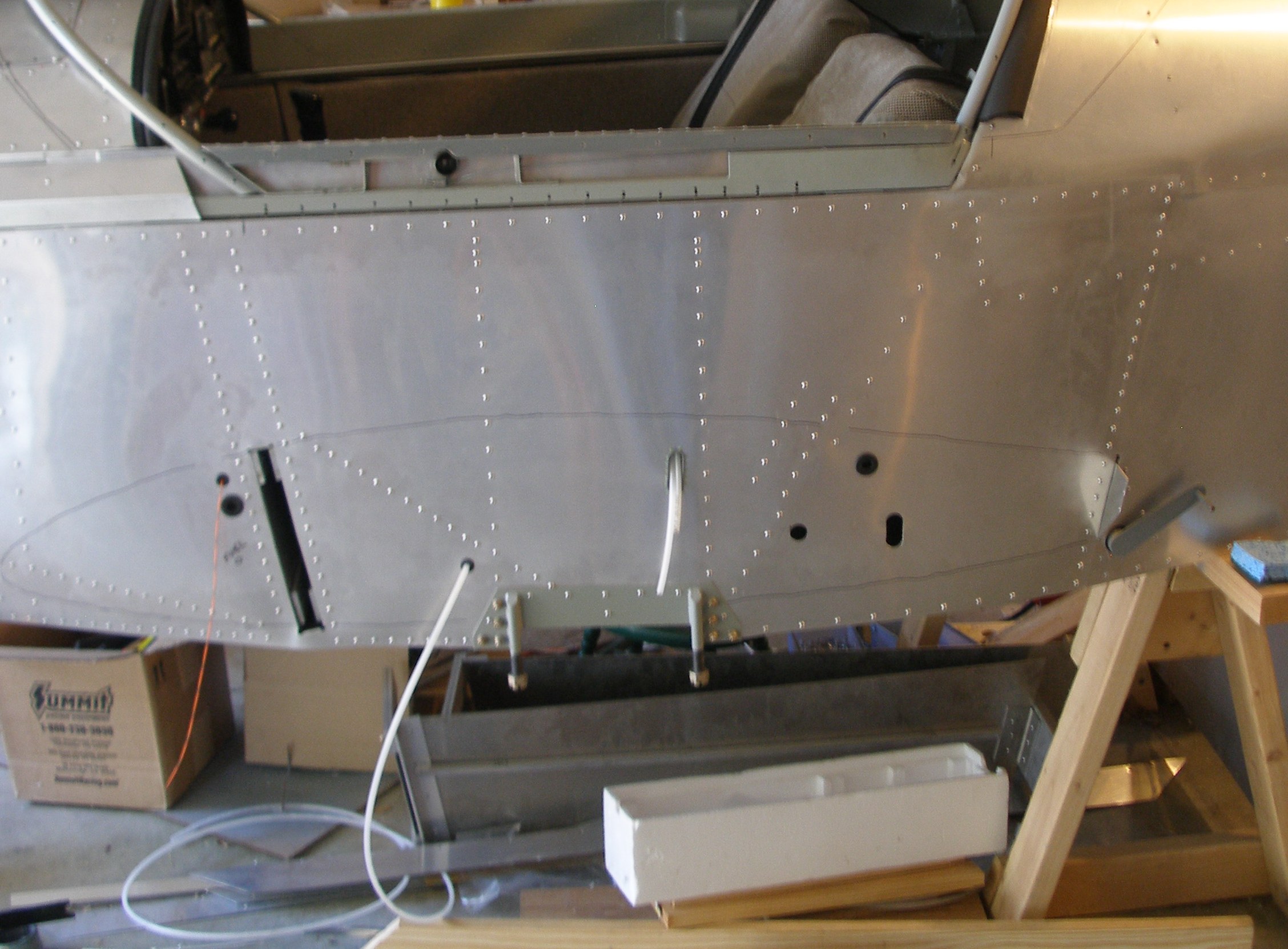

| Description: |
| Filesize: |
549.56 KB |
| Viewed: |
10537 Time(s) |
| Description: |
 Download |
| Filename: |
Aileron_Fairleads.PDF |
| Filesize: |
281.16 KB |
| Downloaded: |
742 Time(s) |

mhubel
Joined: 05 Sep 2009 Posts: 141
Posted: Sun Mar 10, 2013 5:01 pm Post subject: XL Help needed |
Tim,
On the web site n708HU.com picture 0648 may be of some value.
